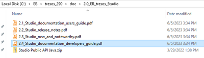

One more point, with DS, the driver (that you've already installed) will be found here:
For some action / note in DS tool, it'll link to the components of DS. So it may important to look up sometimes (as my experience)
