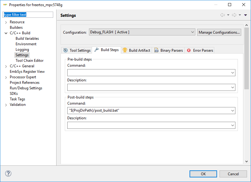

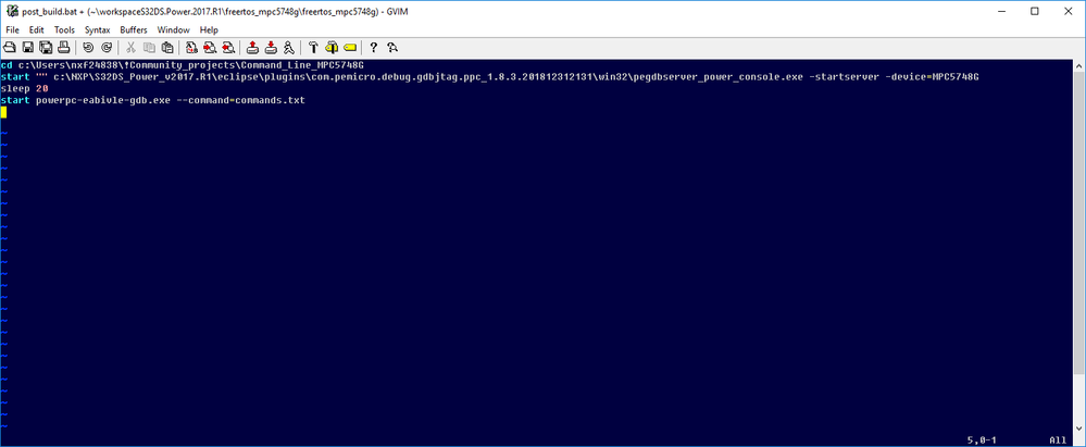

in attachment is post_built.bat script which is working for me. You need to start separate terminal windows:
Add script into post build steps in project properties:
Here is result:

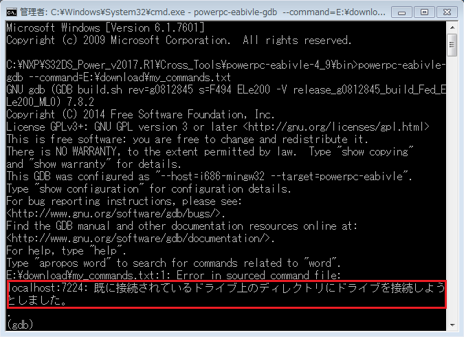

zhouj-fnst
Hi, Jiri
Before I make a mistake.
Now I connect the board to the PC with PE Micro MULTILINK UNIVERSAL.
Method 1:
I ues the following commands:
target remote localhost:7224
load E:\download/examples_r2015.elf
but something error:
The error message(Japanse) means: You tried to connect a drive to a directory on a drive that is already connected.
Method 2:

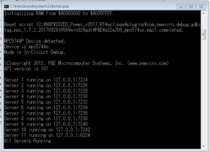

In S32 Design Studio installed path(C:\NXP\S32DS_Power_v2017.R1\eclipse\plugins\com.pemicro.debug.gdbjtag.ppc_1.7.2.201709281658\win32), I execute following command:
pegdbserver_power_console.exe -startserver -device=MPC5744P
Then I execute the commands I descriped in Method 1, the cmd figure is shown as following:
I don't know the difference between above two methods.

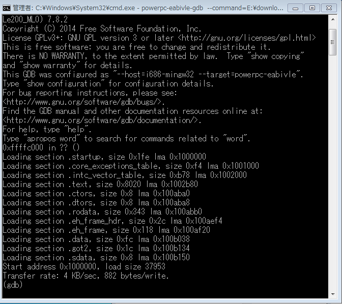

And another question,  in method 2, When I see the message (Transfer rate: 4 KB/sec, 882 bytes/write.)
Does it mean that the program is uploaded into the board? The program is running ? If I want to stop the run of program, I just use 'stop' in CMD window?
7,033 Views
jiri_kral
the error is probably caused by backslash in your load command - E:\ . The gdb client comes from Linux where is used normal slash for directory separator. It should work with load E:/download/examples...
Yes, program was uploaded into device. Here is summary of most common commands:

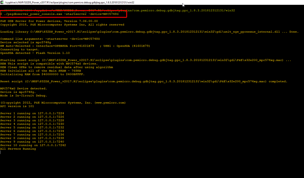

jiri_kral
i did some tests - and the strange message:
means, that there is no gdb-server running.
First of all - you need to start gdb server:
Jiri

zhouj-fnst
Hi Jiri
I think start gdb server is needed before I upload the .elf into the board.
But here is a question.
As you do, I need to open two cmd window when I use commands to upload the program manually.
Step1
Start gdb server. (I could not close the dos window before I open an another dos window to execute step2)
Step2
open an another dos window to enter gdb mode to execute following commands:
powerpc-eabivle-gdb --command=E:/download/my_commands.txt
So how can I do the above steps in one script?

jiri_kral
Here is result:

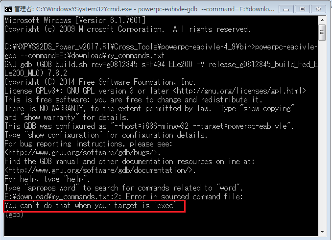

zhouj-fnst
Hi, Jiri.
Thank you for your answer.
By your method, I have some trouble.
I use the command to flash the .elf into the MPC5741P board with PE micro MULTLINK UNIVERSAL.
commands I used are as following:
target exec E:\download/examples_r2015.elf
but something error occurs:
so how can i download the .elf file into the board and debug the program.
Is there any document I can read related with the command?
