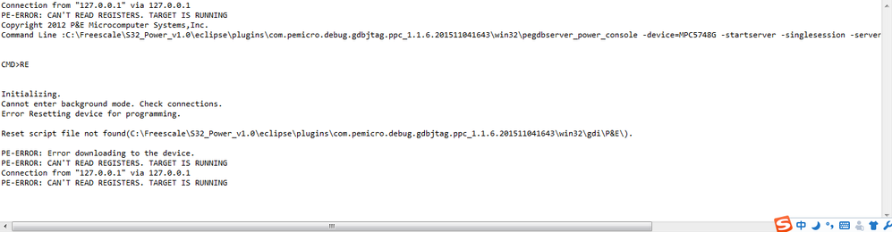

I set up a new blank project of MPC5748G, use Z4_1 and Z4_2 core.
is there any configuration missed?

martin_kovar
at first, try to add a delay after reset into your main core debug configuration
If it does not help, try to upgrade PE Micro drivers.
Martin

jingyu
Hi, Martin!
It did fix the power cycle problem! Thank you.
