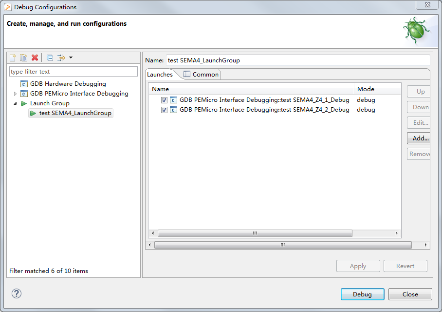

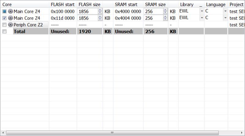

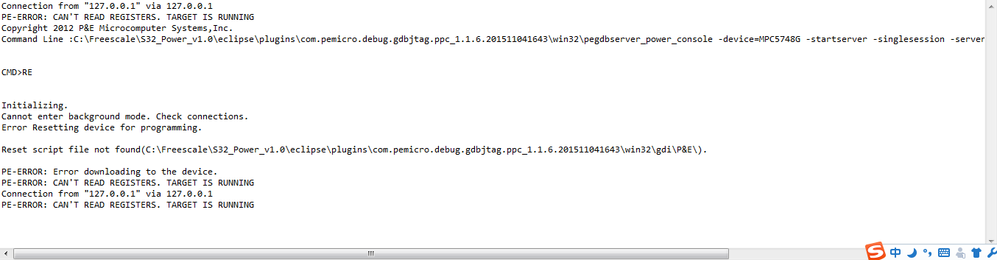

I set up a new blank project of MPC5748G, use Z4_1 and Z4_2 core.
is there any configuration missed?

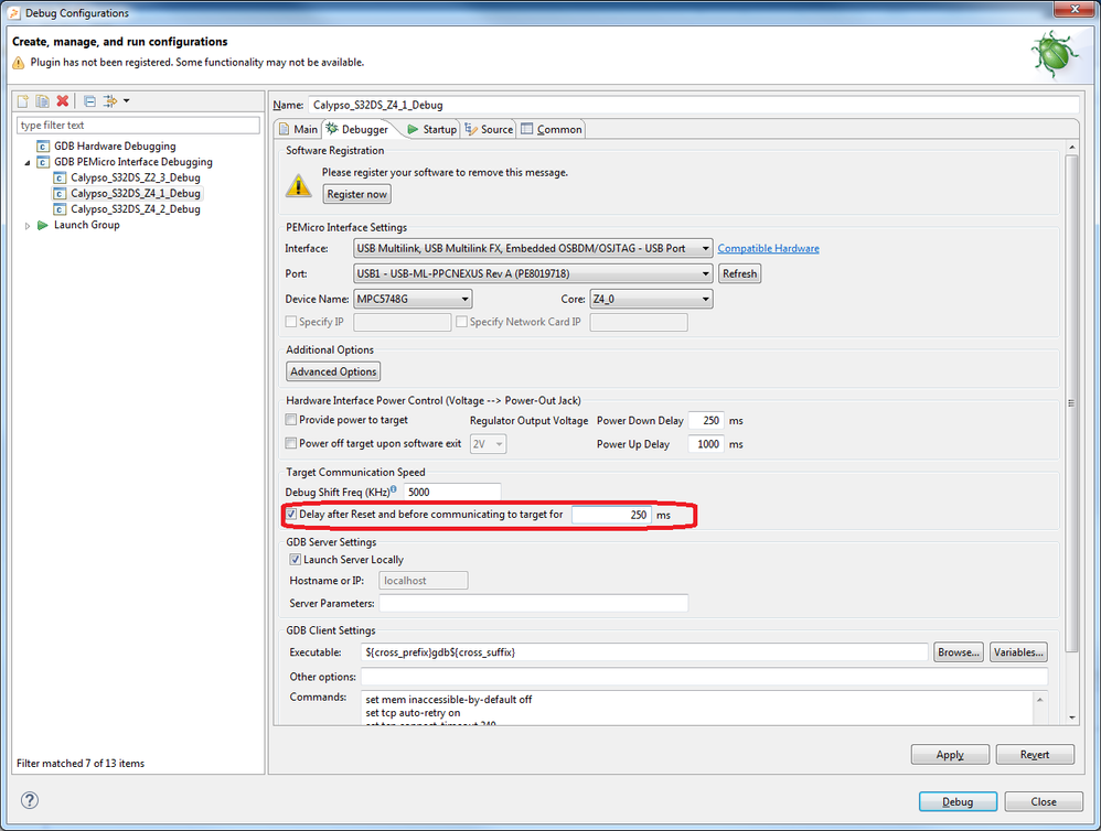

at first, try to add a delay after reset into your main core debug configuration
If it does not help, try to upgrade PE Micro drivers.
Martin
4,973 Views
jingyu
Hi, Martin!
It did fix the power cycle problem! Thank you.
