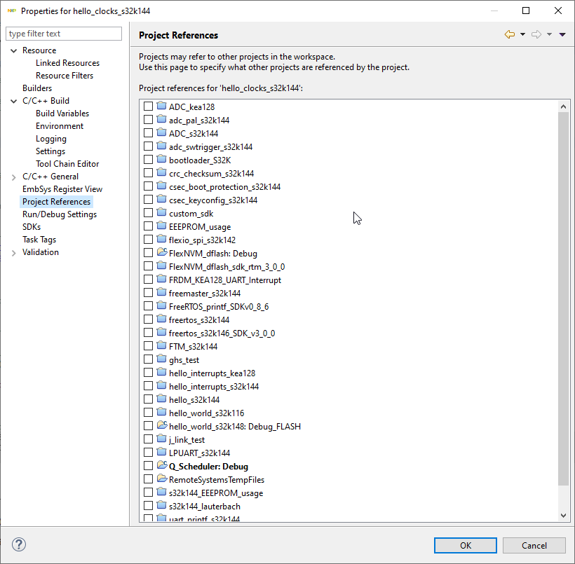

Hi all.
I am using S32DS 3.2, i want to create sub projects under one top level project. Is this possible with S32DS, as i did it with GHS, same i want to do with S32DS.
Please let me know whoever tried this or know how to do ?
Thank you & regards
Shubham

Hi Shubham,
yes, just add to Project Main Project reference for Project1, 2 and 3. Project 1,2,3 left without any other project reference.

Hi @jiri_kral ,
Thanks for the update.
Suppose if i created 4 projects named: Project_main, project1, project2 and project3. If i build project1 then it should create project1.elf, and same for other 2 projects. When i build project_main the it should build all 3 projects.
Is it possible to do?
Shubham

jiri_kral
Hi Shubham,
unfortunately S32DS (Eclipse) doesn't support sub-project inside main one. You can specify dependency on another project in Project properties:
Hope it helps.
