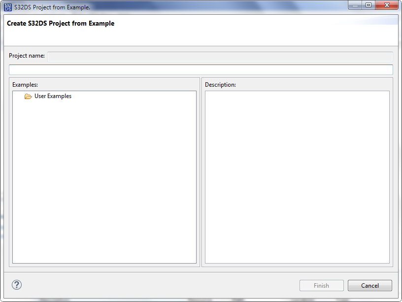

When I create new project from example in S32DS 3.1. It can't find example projects, the MCU is S32K.

S32 Design Studio v3.1 is for S32Sxxx and S32Vxxx MCUs. If you like to use S32K1xx - please download S32DS for ARM v2018.R1 and install uptate.
https://community.nxp.com/docs/DOC-340190
https://community.nxp.com/docs/DOC-341068
