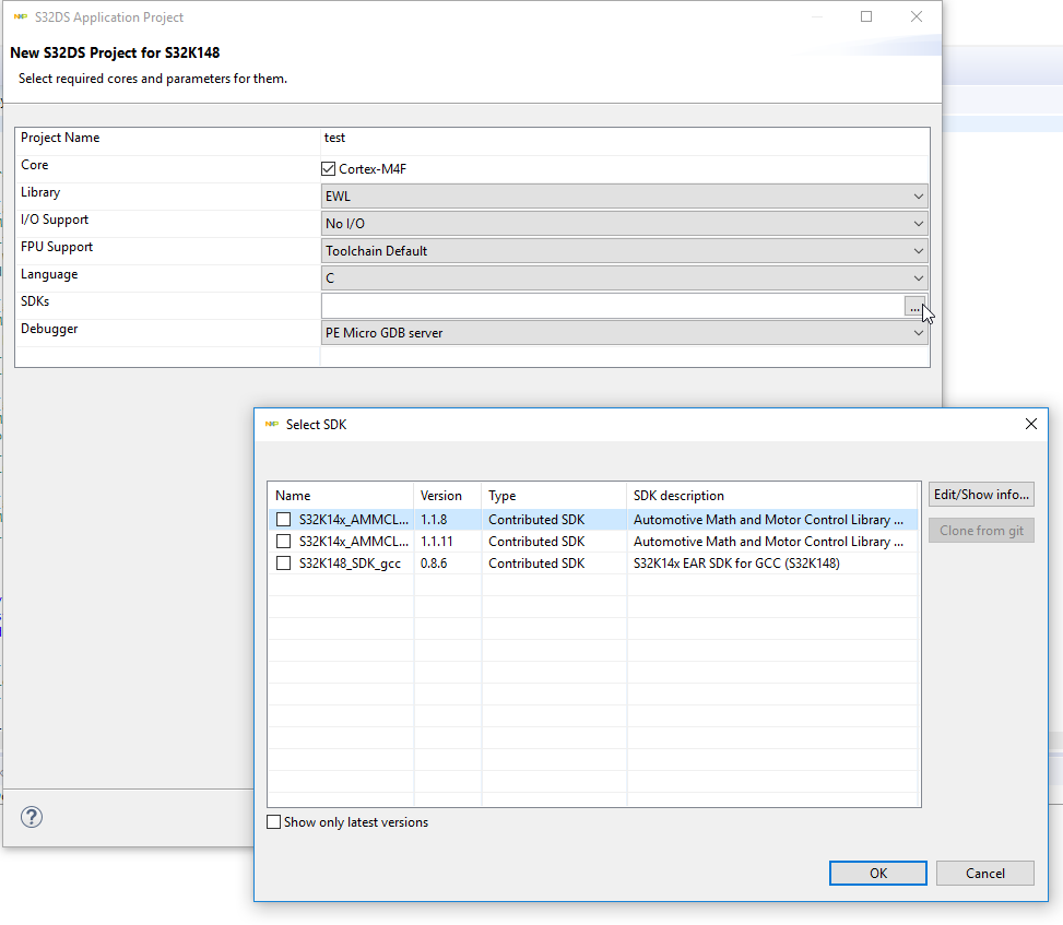

I install newest S32DS_ARM_Win32_v2018.R1_b180326, and create a new S32DS Application Project .
But the views of Processor Expert is empty!  And I cannot generate Processor Expert code!
please, Why?

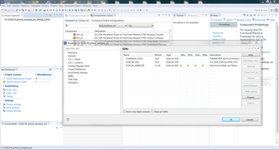

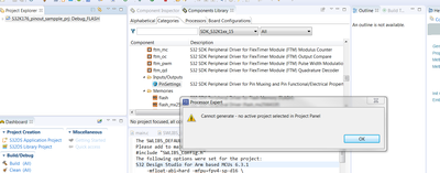

Hi all,
I get the same problem while creating a sample project for the S32K146 target, even if I select the SDK as suggested in the 1st response of @jiri_kral
As you can see, SDK has been correctly selected, but when I click on Project-> generate Processor Expert Code
Any solution?
Thank you in advance,
Andrea Mocci

jiri_kral
Hi Andrea,
AMMCLIB doesn't contain processor expert - it is just library. If you like to use PE feature, you need to select for example S32_SDK_S32K1xx_RTM_3.0.0 SDK.
Jiri
5,961 Views
jiri_kral
Processor Expert is part of SDK - So, you need create new Project and add SDK.
Jiri
