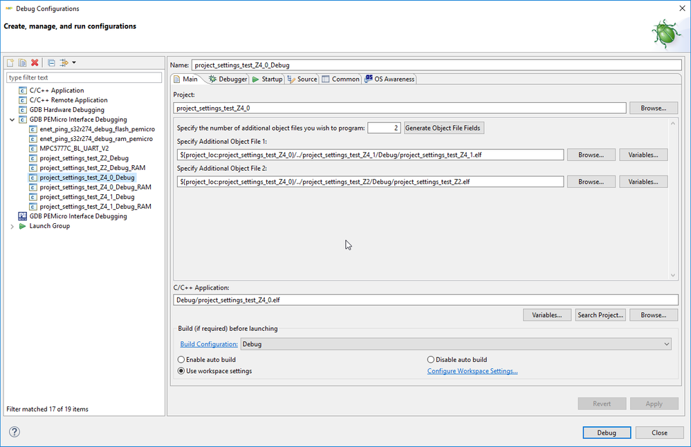

If I disable Z4, Z2 when creating new project, how to enable them and add relative code?

multi-core project technically works as three projects with different linker scripts setup for each core. You can modify linker files later.  You should know prior the project creation how many cores you will be using.
If you have for example three core project - you can remove other core elfs from debug session and use for example only boot Z4_0 core - just set number additional object files to 0

If I set number additional object files to 0 in 3-cores project, does it means only Z4_0 is active, then Z4_1 and Z2 are disabled.
So I can say that Z4_1 and Z2 are not consuming power?
