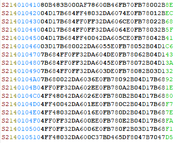

I want to assign functions to specific address when generating binary files.
So I use #pragma arm section . But Warning is occured and Don't process it.
How to assign functions to specific address?
Like below :

you can use the following attribute for functions:
__attribute__((section (".flash")))
See the examples at the end of Execute-Only Code with GNU and gcc
or Putting Code of Files into Special Section with the GNU Linker
I hope this helps,
Erich

Hi Erich,
Thanks for your help.
Like as your mention, The function is writted at the address I want in binary.
