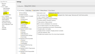

Also, you could try the following configuration:
- Remove the "-fno-short-enums" option (Project Properties > C/C++ Build > Settings > Optimization)

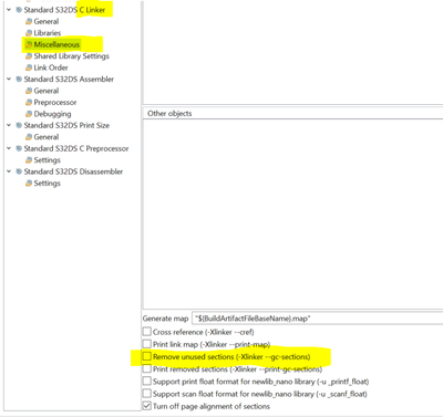

- Check the "Remove unused sections" (Project Properties > C/C++ Build > Settings > Standard S32DS C Linker > Miscellaneous)
