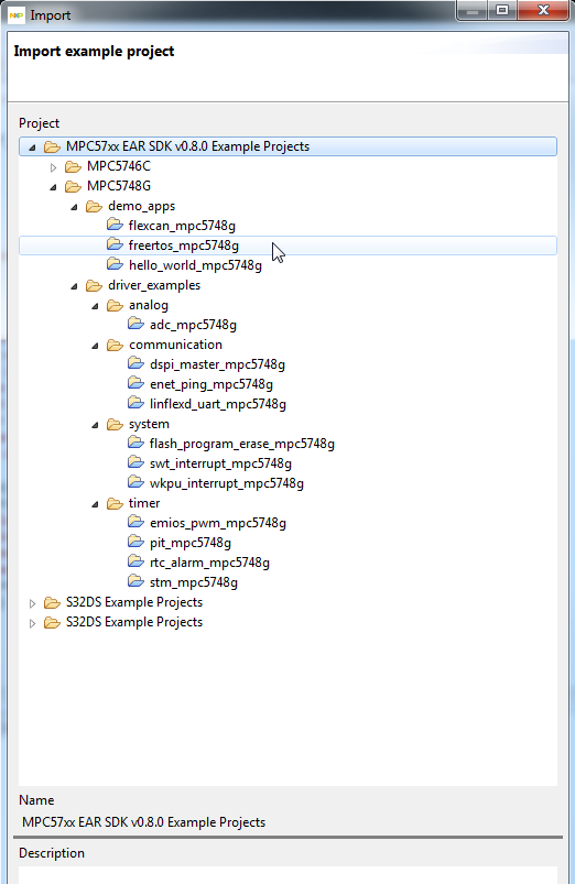

best way how to use FreeRTOS with S32DS is starting from SDK example (part of S32DS). On the main menu  bar click on File -> New -> S32DS Project from Example
In MPC57xx EAR SDK v0.8.0 Example Projects folder choose MPC5748G -> demo_apps -> freertos_mpc5748g

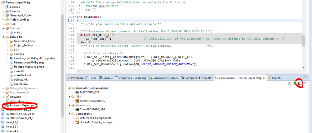

I haven't been able to compile anything from the MPC57xx EAR SDK v0.8.0 examples.
I'm getting a missing Cpu.h, which doesn't exist on my hard drive. Is there another set of packages that we need to install to compile it?

Hi Jed,
You have to generate code from the ProcessorExpert tool,just like this捕获.PNG

Hi Jiri,
I have done these steps,but i only got one project,and this project was still lack of many files.How can l achieve three projects like other examples such as the 'Hello' example.
