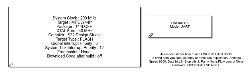

And then I open the example model file from the Model-based Design Toolbox. The model is "uart_model_pnt".

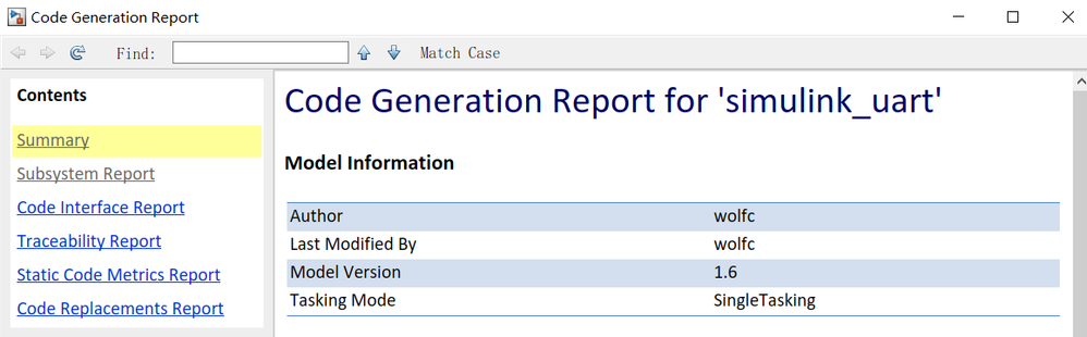

 After that I configure the parameter and build the model, and then the Simulink generate the C code.
After that I created a new project in S32 design studio and replace the source file and header file with the C code generated from Simulink.
