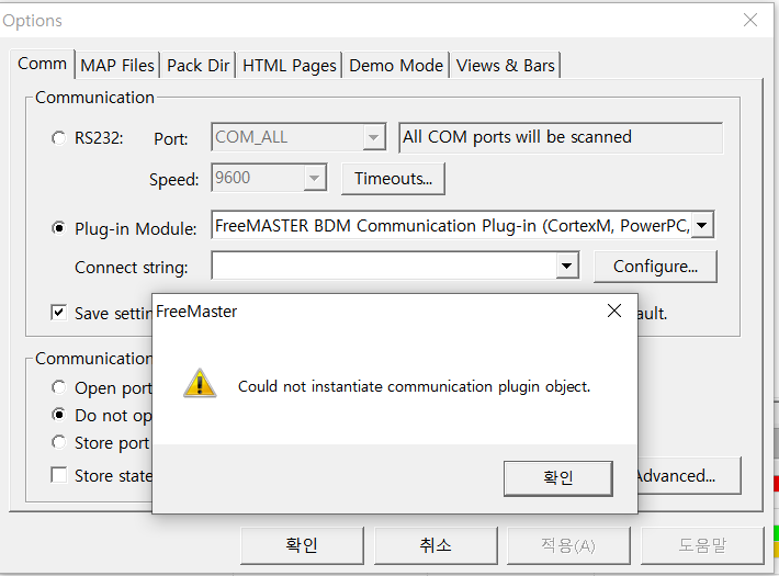

In Freemaster and Cyclone fx document, ODM is available.
I try to change configuration of Freemaster but it is not working
In the Freemaster, strange pop -up is comming on Option tap like below

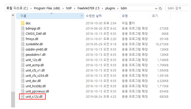

But there are plugin object when I check the directory C:\Program Files (x86)\NXP\FreeMASTER 2.5\plugins\bdm

When I update PEmicro & Cyclone drivers, the problem is solved

The DLL files that are in this location may be a little outdated. PEmicro will be able to provide you with the latest files that should get you up and running with the newest version of FreeMASTER. I would suggest visiting the homepage www.pemicro.com and going to the "Support" tab. Here you can setup a Support Request and a representative will be able to provide you with the necessary files once that is done.
