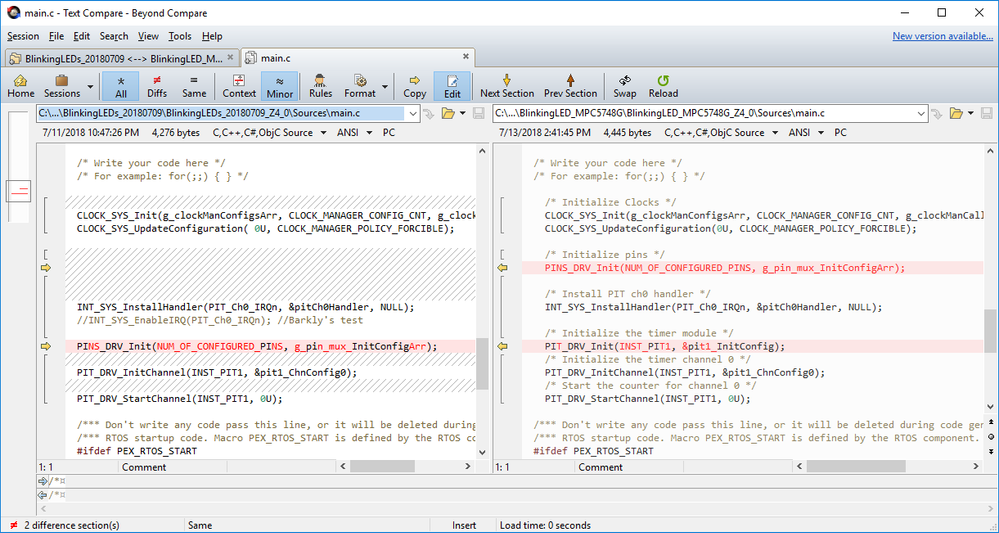

 -> LED blinking is not working here
GPIO is not pulled high/low constantly, because void pitCh0Handler(void) is not triggered.
 -> SIUL2->GPDO[0] ^= SIUL2_GPDO_PDO_4n_MASK; // DEV-KIT
Anyone has the same problem?

From the project you provided, it appears you have not performed a build. Is this correct?
There is no executable (ELF) and there are no object files, etc.
I just built your project and it built clean, however, when I compared the files, I found a difference in the main.c.BlinkingLED_compare.png
You are missing the call to PIT_DRV_Init(). If you add this call, then the LED will blink.

Hi Mike
Yeh, your right, I missed one line.
It works now.
