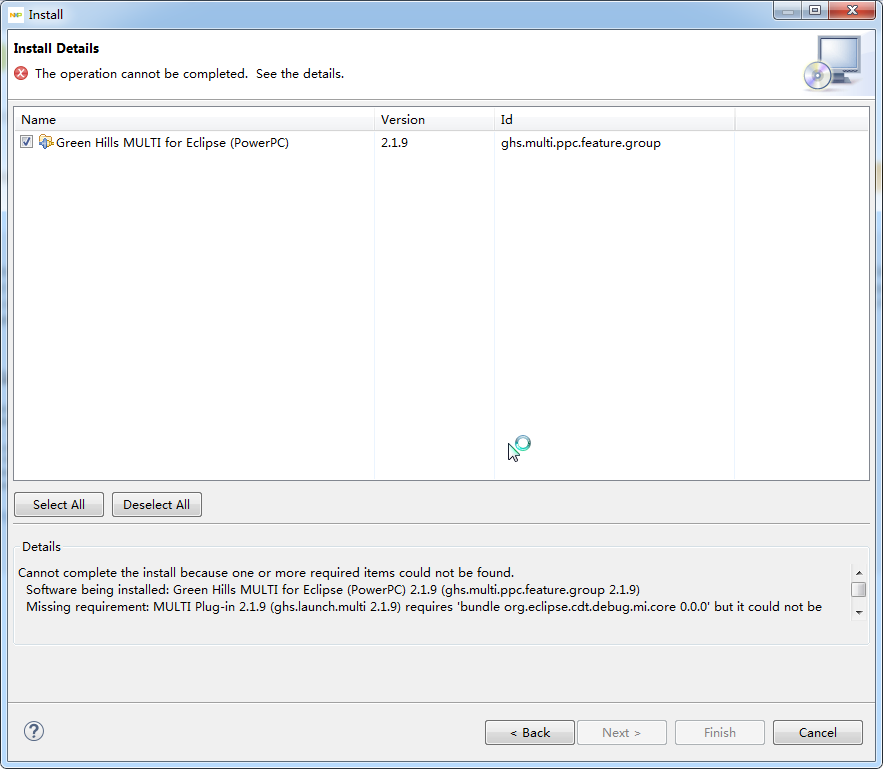

Dear Engineer:
I update  S32 Design Studio for Power Architecture from version v1.2 to version 2017.R1.I found a issue ,when I integrated the GHS compiler toolchain in S32DS there was an error .
Details:
Cannot complete the install because one or more required items could not be found.
Software being installed: Green Hills MULTI for Eclipse (PowerPC) 2.1.9 (ghs.multi.ppc.feature.group 2.1.9)
Missing requirement: MULTI Plug-in 2.1.9 (ghs.launch.multi 2.1.9) requires 'bundle org.eclipse.cdt.debug.mi.core 0.0.0' but it could not be found
Cannot satisfy dependency:
 From: Green Hills MULTI for Eclipse (PowerPC) 2.1.9 (ghs.multi.ppc.feature.group 2.1.9)
 To: ghs.launch.multi [2.1.9]
I uninstalled the S32DS and GHS to reinstall,the problem will still appear.
I do not have this problem When I use S32DS for Power Architecture version v1.2.
Best Regards!
