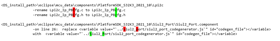

jiri_kral
Hi Mark,
unfortunatelly RTD is not officially supported on Linux host (that's why you need to install it from offline source) and is not tested. Anyway - the Siul issue is related to Case Sensitive OS. If you like to use it - you need to modify some files. If your project is more complex - you probably will need to modify similar files for other modules.
Here are instructions for siul and lpi2c:
