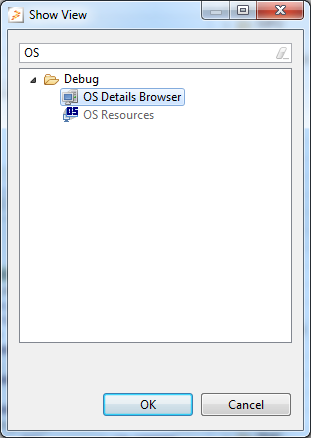

   I am using S32 DS with MAC57D54H.  I am using the P&E multilink with this setup.

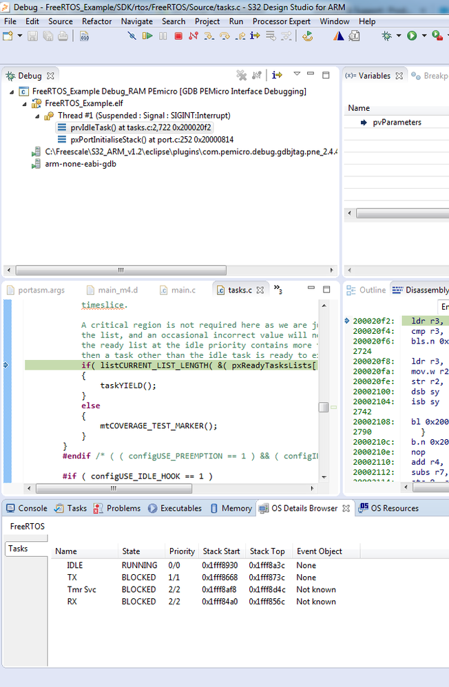

   I have set the OS Awareness to "FreeRTOS" in "Debug Configurations".  However, I do not find the option to see the FreeRTOS details in debug view. (Task lists, variables, etc).
   How do I get the OS aware view during debug?
Raghu S
2,484 Views
stanish
Hello Raghu,
There is "OS Details Browser" View which displays all the tasks + details. Go to  menu Window -> Show View -> Other .. -> Type "OS":
Unfortunately this view is not automatically added into your debug perspective if FreeRTOS aware debug is selected so you have to do it manually.
