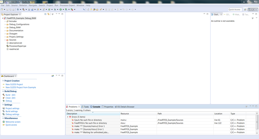

ziomocci
Hi Stan,
 I am following the tutorial, but when I try to build the example unfortunately I find few problems as depicted in the screenshot.
It seems, very strange, that the requested headers are not present.

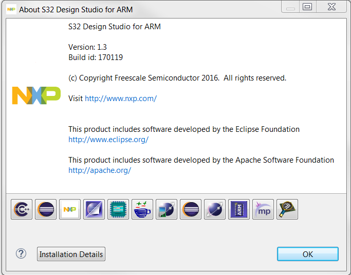

I am using this version of S32DS
Any suggestion would be very appreciated,
B.R.
Andrea Mocci

ziomocci
Problem solved Stan!!!
I have not noticed that Processor Expert configuration shall be build before!!!
Consider the problem closed (for now at least :smileyhappy: )
B.R.
Andrea
