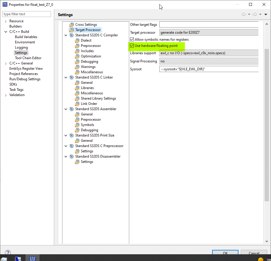

Hello Team,
I am using use the compiler -powerpc-eabivle-gcc-4.9.4 located in "\nxp\S32DS_Power_v2.1\S32DS\build_tools\powerpc-eabivle-4_9\bin". We are getting following errors while we are compiling our code:
1. undefined reference to `__extendsfdf2'
2. undefined reference to `__extendsfdf2'
3. undefined reference to `__floatunsidf'
4. undefined reference to `__umoddi3'
5. undefined reference to `__gtdf2'
6. undefined reference to `__udivdi3'
I am using  MPC5777 e200z7 core. Am I missing any compiler flags to address this issue or are we missing anything in the compiler to add the above mentioned floating point functions?. Please help

you may find helpful this StackOverflow article:
https://stackoverflow.com/questions/53402307/powerpc-gcc-floating-point-instructions
Also make sure, that HW float point is enabled in your project properties:
Jiri
