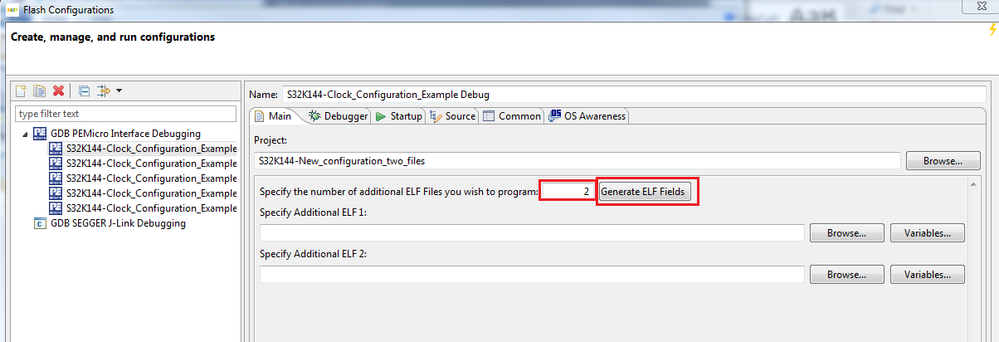

If you want to load 2 different elf files, please use debug configuration.

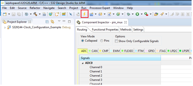

First, click on the lightning icon
Create new PeMicro Interface Debugging configuration. Choose 2 elf files and click Generate ELF Fields.
Specify paths to elf files.
Last, check all other debug settings.

i can not find this lighting icon on my S32!! we used CW for along time but we want to migrate our CW projects into S32. So i import the CW project in S32 but i can not see this icon!

which version of S32 Design Studio you use?

i am using the V1.2.
