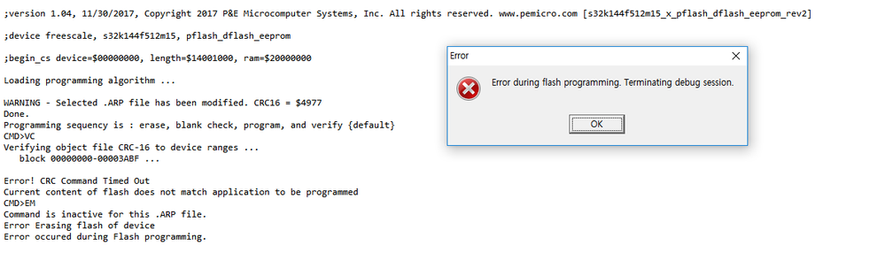

I use S32DS and S32K144.
When I test the flash write, I wrote the test data at adress 0x00.
After that, I can't flash program.
How to resolve it?

Seems the flash configuration block was overwritten.
Please check this thread:
https://community.nxp.com/message/1062800#comment-1063606
Are you able to connect and load your project into RAM (Debug RAM build config)?
Stan

kbj
Dear Sliva,
Thanks for your help.
I solve it, Thanks to you.
Byungju.
