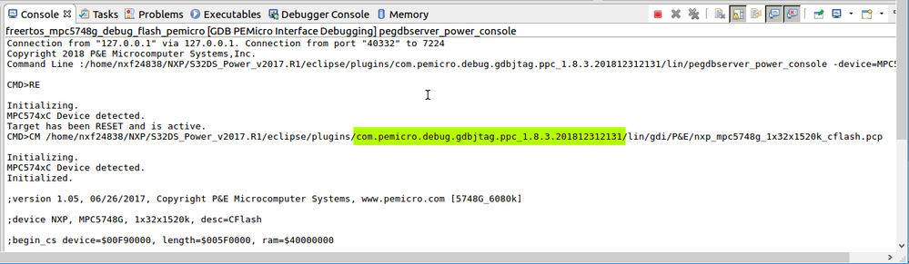

I am using S32 design studio ide for mpc5748g controller programing.
Here I am facing issue of flash debugging, I could not able to debug in flash.
While ram debug option working fine.
Attached screenshot of issue which i have facing. let me know what could be the reason?

Hi Rajani,
it looks that you are using old PE Micro plugin. Please update S3DS https://community.nxp.com/docs/DOC-342273  and try it again:
With latest version I have no issue on Linux host (Ubuntu 16.04 LTS)

I have Updated latest PE Micro plugin version(1.8.3.2018) in S32 Design studio but still s32 flash debugging option not working.
I think flash memory is locked. so flash debugging option not working.
can you please give me suggestion to resolve this problem.

jiri_kral
you can try PE Micro tool PROGPPCNEXUS to erase chip (unfortunately for windows only - but there is chance that this SW will work with Wine). You can find more details in this thread:
https://community.nxp.com/message/1108728
Hope it helps.

jiri_kral
in my opinion debug probe doesn't solve your issue. MCU can be erased with existing OpenSDA interface. Just use steps described here - https://community.nxp.com/thread/494855
Jiri

aniket_patel
Thanks Jiri Kral, for resolved this problem.
