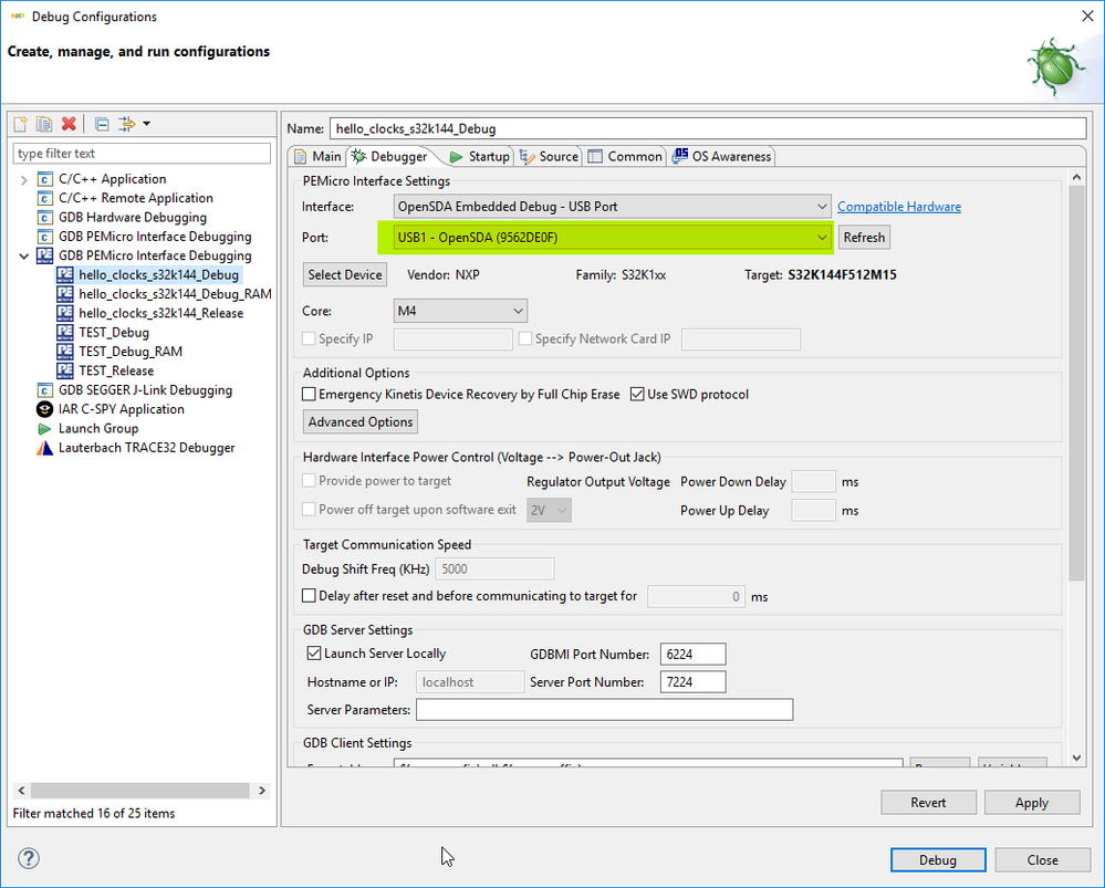

I want to know how to flash the file in S32k144 EVB board by using s32 design studio. I m facing error as,
"Remote communication Error : Target disconnected" No error.
Kindly share the steps for flashing the files in s32

open debug configurations, select your debug target on the left side, check if OpenSDA PE Micro is detected and click on debug button:
Also make sure that you have selected power from USB - J107 jumper on 2-3 (closer to USB connector). There is no special settings needed.
Can you please attach output from your debug console?
Jiri
