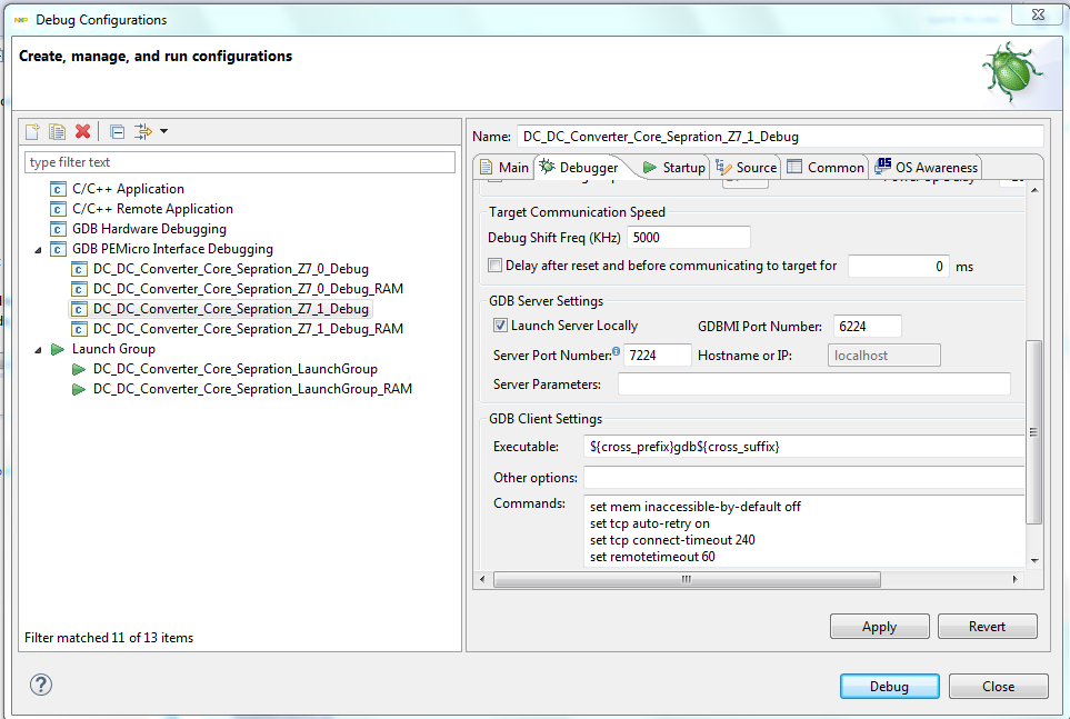

Till now we were using only Core 0. We have successfully able to debug & test GPIO,PWM,CAN,SPI etc
modules using Core 0.
Now we have written pin toggling program in Core 1 & trying to debug it.
It shows that debug done 100%.
But when we try to do single stepping we are not able to do that.
We are setting debug configuration similar to what we are doing for Core 0.
We have stuck here.
Please guide us.

Hello Rahul,
here is HOWTO document related to muli-core debugging - https://community.nxp.com/docs/DOC-335367

jiri_kral
you are probably starting second instance of gdbserver by Z7_1 debug. Please check if Z7_1 debug isn't starting gdbserver (screenshot is taken from S32R274 - but it is very similar as your MCU).
and also Z7_1 is only attaching to running server:
Jiri

rahulmankumbare
we are able to debug core1.
Thanks.
