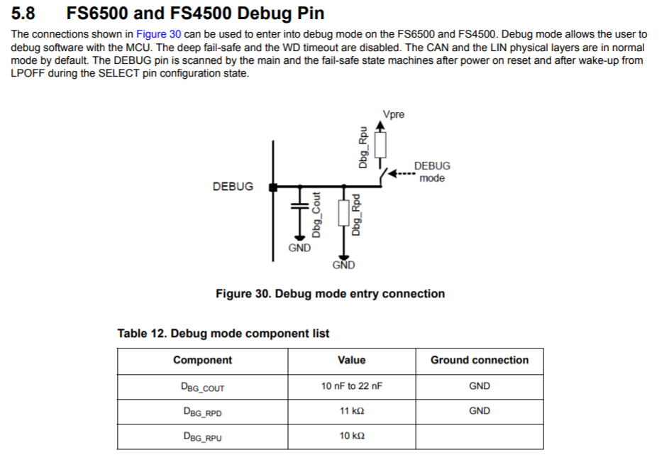

I have an FS6500 connected to MPC5746 and want to test the CAN communication via the FS6500 CAN interface.
Section 11.6 /page 31 the FS6500 Datasheet Rev3.0 states that
"In debug mode, the CAN transceiver is set to normal operation mode by default allowing CAN communication without SPI configuration."
Following the directions mentioned in AN5238 (reproduced here for convenience) I connected the 10K Dbg_Rpu resistor
After reading the above two, it seemed that I do not have to do any prior configuration of the FS6500.@ If I put the SBC in debug mode and configure the CAN interface on the MPC, and connect the TX/RX between the MPC and FS6500, I should be able to send/receive messages via the FS65xx CAN interface.

CAN1 communication does not work - I do not see any output from the FS65xx CAN transceiver. I confirmed that MPC outputs TX data and on the FS65xx, data arrives at pins 20(TxD) but there is no output on pins 8/9 - the CANH/CANL  outputs. The problem appears to be localized to the FS65xx chip
CAN-2 works as expected.
1. Has anyone tried exercising the CAN interface on the FS65xx when it is in debug mode, without doing any prior configuration via software?
2. How do we know for sure that FS65xx is in debug mode?
3. If the FS65xx is wired as above, for debug mode and no other configuration has been done, what should be the values of these bits if I read the register over DSPI:
a) DBG_HW bit (bit 0 )of HW_CONFIG register
b) CAN_Mode_1, CAN_MODE_0 and CAN_AUTO_DIS (bits 7:5) of CAN_MODE register
4. If setup is required even if debug mode, what is the minimal configuration that must be done.
I need to determine if the chip is bad or if it is only some missing configuration. If you have an example, that would be very helpful.

It is not possible to enable CAN on the FS65xx SBC WITHOUT initializing the FS65xx first.  Please  test  and  confirm and correct documentation if necessary.
SPI betweeen  MPC and FS65 must be setup and then the FS65_Init() / FS65_Config_NonInit()  function ( see the FS65xx driver example) has to be executed AT A MINIMUM before CAN is enabled.
I tested my board that contains MPC5745 and FS6513 using these same steps.  It is solely the users responsibility to consult the latest Reference documentation for the SBC and MPC they use.
Here is a cheat sheet for testing only the CAN Interface on SBC
1. Wire the SBC Debug pin for Debug mode operation.
2. Wire the SBC Select pin to disable DeepFailSafe i.e connect to VPRE. ( See Note 1 below).
3. Power up the board and check voltages as mentioned in the document. Pay special attention to the voltage at the debug pin.
4. Create a test program for your MPC that includes
       a. Initializes  MPC to SBC CAN ports and configures  corresponding CAN Interface
       b. Initializes  MPC to SBC DSP ports and configures corresponding interface
       c. FS65xx_GetStatus()   (See Note 2 below)
       d. FS65_Init(); FS65_Config_NonInit();  (See Note 3 below)
       e. FS65xx_GetStatus()  (See Note 2 below)
       f. CAN_Send()  and CAN_Receive() code.
5. Execute the  test program - SBC CAN should work.
Note1: This connection disables DFS  and is suggested for DEBUG use only. This must be changed if you need DFS in your final product.
Note2: Check the HW_Config() and DIAG_CAN_FD register values to find SBC state and CAN interface state.
Note3: Check and modify struct FS65_Registers_InitValues as necessary for your hardware setup/environment.
Hope it helps.
