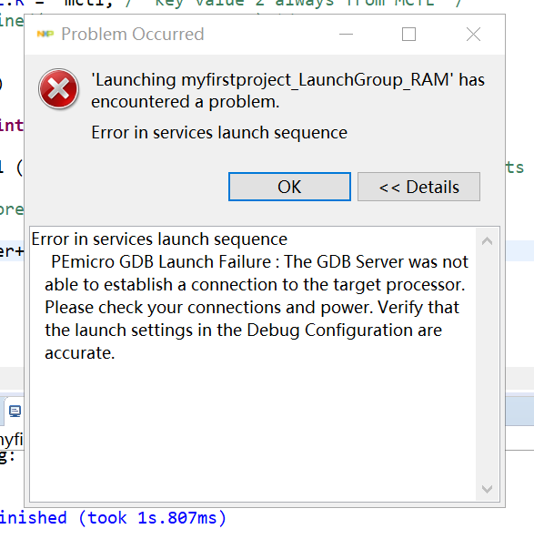

I'm first time using S32DS,I am trying to program and debug MPC5748G using openSDA #example project
.but it was failed and give me some information  as follows:
Is the hardware connection correct?
Can anyone, experienced same issue share how to resolve this?
is this known issue?

it looks like that there is no OpenSDA firmware on your board - the green LED next to RJ45 is flashing, isn't it?. Try to update it - https://community.nxp.com/docs/DOC-340263
Jiri

   I have a question,when I'm debugging, I need 12v external power supply ?
3,500件の閲覧回数
jiri_kral
no, you can use USB for power. Actually - with close look at your picture again - you have selected External power by J11 jumper. For USB power should be shorted pins 2-3.
