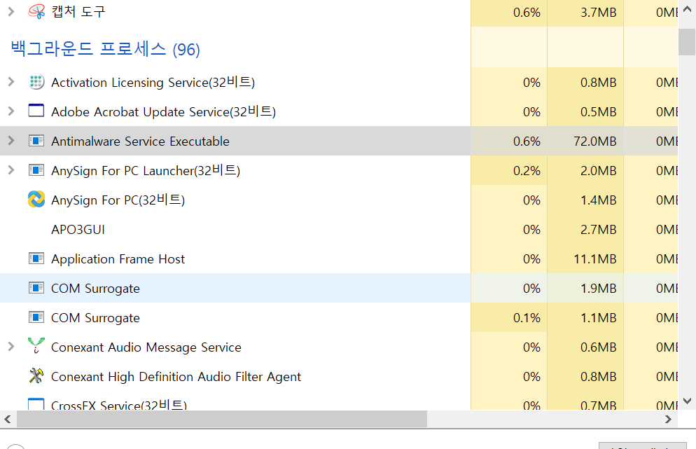

BlackNight
The same thing applies to S32 Design Studio: have you checked your task list for another server running?

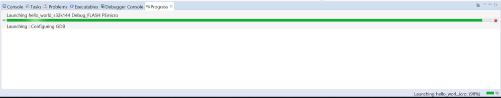

tkdwofl
stuck at Fault
when Ram Debug worked well. but Flash mode is happened Error.
and  i can not find arm-none-eabi-gdb...
11,081 Views
BlackNight
It would be pegdbserver_console.exe for P&E.
And check your launch configuration settings. It could be that your problem is this one: Solving “Launching: Configuring GDB Aborting Configuring GDB” | MCU on Eclipse

tkdwofl
no..it is sill stuck on config..
how to reset Flash memory..?
