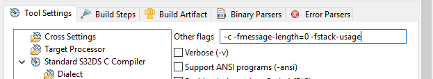

Enabling fstack usage in misc:

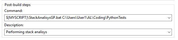

and adding the path as post build script:
The generated bat file (DoStackAnalysis.bat) can be launched from the folder.
