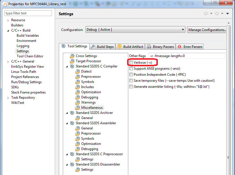

With the "Freescale GCC Error Parser" turn on, I am getting lots of noise in the error messages list.  This appears to be a bug to me.  This is turned on by default in the project template.  What would I be missing if I disable this parser?
See include screen shot of the error message noise.

    This is a lib project that is targeting the MPC5644a,  "sdk" is in the name of the project,
The problem is that the "Freescale GCC Error Parser" picks up info lines in the build log/console and reports them as errors.
-Ron

Thanks for your report. This is a known issue (S32DS-387)
It seems that you enabled verbose mode ("-v compiler option") since the compiler version is listed in the console for each compilation unit. Please disable this option as a workaround:
This should be fixed in the next release S32DS for Power v1.2 that will be released by the end of May 2017.
Hope it helps.
