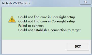

I am working with my own boards(S32K144).
J-link can't connect the board :
Connecting to target...ERROR: InitTarget(): PCode returned with error code -1
ERROR: Could not connect to target.
Target connection failed. GDBServer will be closed...Restoring target state and closing J-Link connection...
Shutting down...
(S32DS v2.0)
Connecting to target...ERROR: Kinetis (connect): Communication error while accessing MDM-AP.
Shutting down...
(S32DS v1.3)
The code that may make it happen:
for(j=0;j<0x20;j++)
ret = FlashEraseSector(&flashSSDConfig, address+FSL_FEATURE_FLS_PF_BLOCK_SECTOR_SIZE*j, size, pCmdSequence);
Did anybody have a similar issue? Any ideas are welcomed.
Thank you very much.

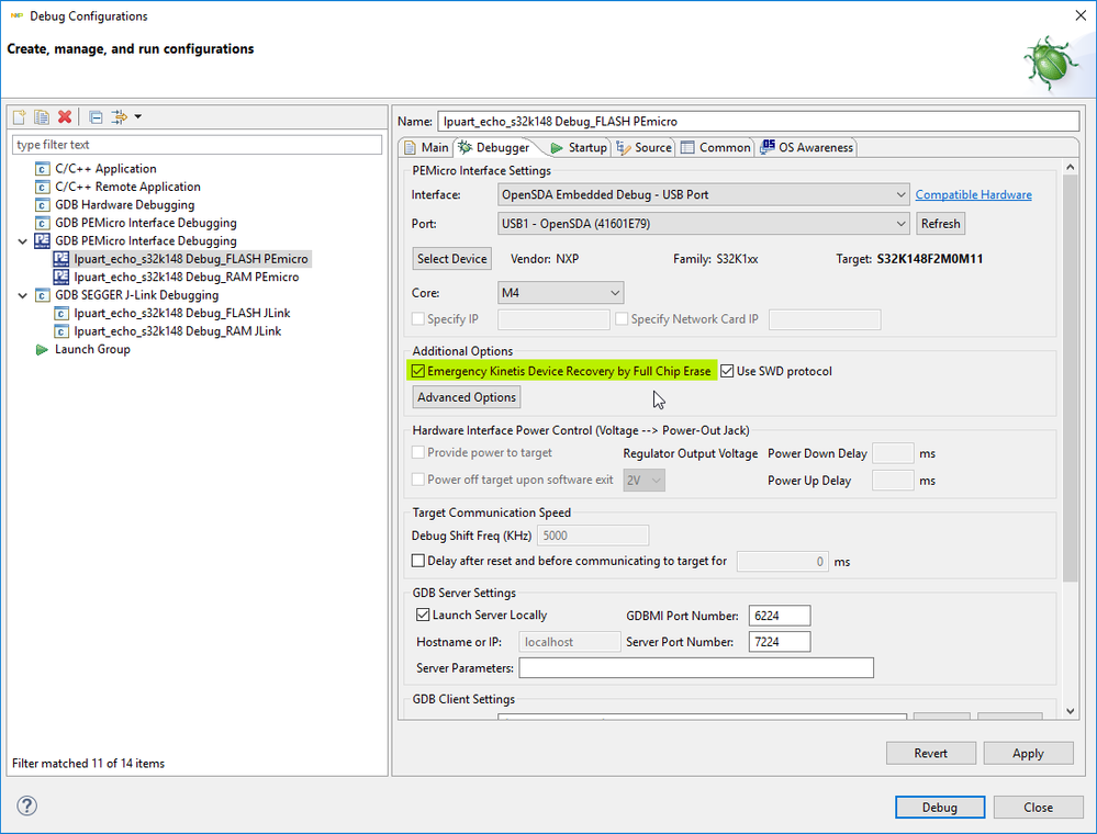

I'm assuming that debugger and connection to board is okay. So - please check if the board is powered properly.  If yes  - you probably secured MCU by writing some unknown data to flash config address - 0x400. If it is your case - there is no way back. Secured chip has disconnected JTAG.
If you have another debugger - for example PE Micro, you can try Emergency Kinetis device recovery option:
If everything fails - the soldering iron is only option.

I burned the program with the Flash erase code . After that the board cannot work when I burn any other program including example .
I tried J-Flash. When I connected the board, I got the error.
I have made two boards not work.
Can you give me some advice to make the connection successful ?

if your chip is secured, back door key disabled and mass erase disabled - there is no way how to recovery MCU (as far as I know). Technically JTAG connection is cut off and you can't connect to MCU even with RAM target. If you are able connect at least with RAM Target project - you can recovery your MCU.
Hope it helps.
