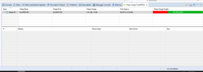

Hi Guys,
I have a strange behaviour in our system. We are developing an application for S32K146 processor and IDE is S32 Design Studio V3.3. While debugging, I am observing that after a few function calls, it is reseting the board. Is it because of RAM being used dynamically to the fullest. How to know that RAM has been used up fully. BTW, this application is on FreeRTOS OS.

I'm not familiar with TaskAware debugger plugin. S32DS already contains tools for FreeRTOS debugging - Heap usage can be checked by Heap Usage tool:
All tools related to FreeRTOS can be found on main menu bar:
