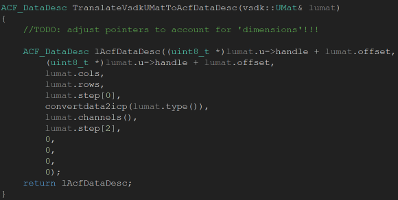

access to ACF_DataDe TranslateVsdkUMatToAcfDataDesc ?螢幕快照 2018-01-10 下午12.30.21.png

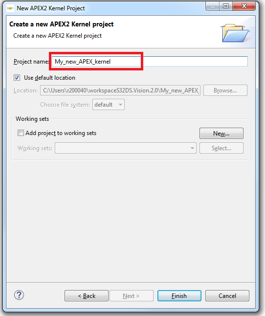

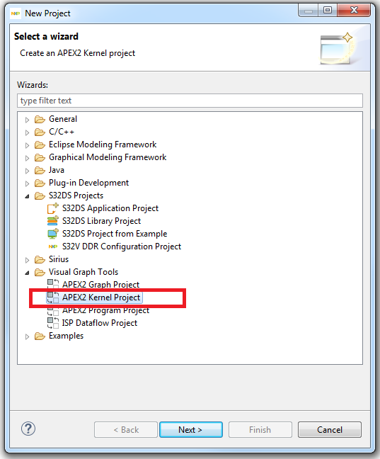

stanish
Yes, you can create and build your custom APEX kernel in S32 Design Studio for Vision.
I'd recommend you to start with a new APEX project using Graph tools.
Select File -> New -> Project:
Hope it helps.
