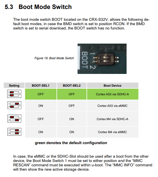

mikedoidge
Hello Ahmed,
To change this, you need to adjust the Boot Mode Switch as follows:
This was taken from the SBC-S32V_User_Manual.pdf, which is found on the page:
S32V2 Vision and Sensor Fusion low-cost Evaluation Board | NXP Semiconductors
Mike

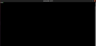

Also this is what I get from the USB connection when the board is set to boot from the SD card while the SD card is removed.
My target is to debug the Cortex A53 core using the S32 Debuge Probe. Can you please direct me to what is wrong or what should I do?

For #2, this should be working. Probably something is not setup correct. Could you please provide a screen capture of the Debugger and Startup tabs for the configuration 's32v234_cortex_a53_A53_0_0_Debug_FLASH_S32Debug'?
Also, in case you haven't already noticed, it is good to cycle the power to the S32 Debug Probe occasionally. Perhaps every time it has been idle for more than 30 minutes? I'm not sure of the duration, but it eventually goes into a state where it doesn't respond and needs to be reset. Probably isn't your issue here, but it's worth a try. I always cycle the power as a first check anytime I have a connection issue. Sometimes cycling the power to the EVB helps.

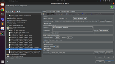

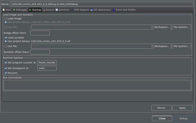

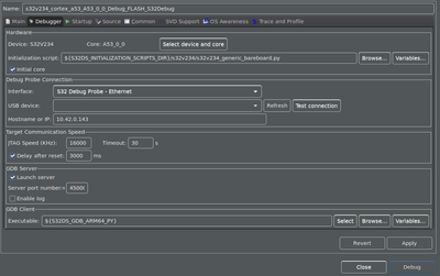

ahmedgheith
Hello Mike,
I just tried cycling the power of the board and the debug probe, but unfortunately I'm still getting the same error.
Here are the captures:
Screenshot from 2022-04-26 17-50-06.pngScreenshot from 2022-04-26 17-49-53.png
28,968 Views

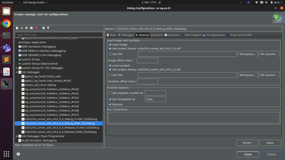

mikedoidge
Hi Ahmed,
I see a major issue right away. You didn't check the box for 'Load Image' on the Startup tab. If the debugger isn't loading the image, then there's nothing to debug on the target.
Mike
28,965 Views
ahmedgheith
Hi Mike,
I checked the box for 'Load Image', but unfortunately I'm still getting the same error.

mikedoidge
Hello Ahmed,
I have investigated the issue. It seems I need to provide some clarification.

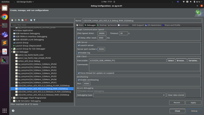

For the bareboard A53 project (no Linux support), the RAM build can be loaded by the debugger directly to the SRAM on the target and executed. The FLASH build must be programmed to FLASH memory using the '<project_name>_FLASHER_S32Debug' configuration under the 'S32 Debugger Flash Programmer' heading in the Debug Configurations menu. The process to use this is detailed in the S32DS user guide. Briefly, you must use the '<project_name>_FLASH_S32Debug_group' configuration under the 'Launch Group for S32 Debugger' heading in Debug Configurations menu to perform the flashing then start of the debug session. Both of the _FLASH_S32Debug and _FLASHER_S32Debug configurations must have the communication settings configured before using the launch group. I should note, the S32 Debugger Flash Programmer will only work for NOR Flash Memory devices which are connected to the target via the QuadSPI. I could be wrong, but I believe there is no such device installed on the SBC-S32V234 EVB.
However, this is only an answer to half of your issue. You had same error with the RAM build. I was not able to reproduce an issue with the RAM build of an empty project created in the same way as yours and with the same packages installed to S32DS 3.4.
The screen images you provided were for the FLASH build. Could you provide the same images for the RAM build debug configuration? Perhaps there is a clue.
In addition, make sure you check the box for 'Enable log' under the GDB Server settings on the Debugger tab. There is also another log, GDB Traces, which can be helpful. To enable this, go to Window -> Preferences, then in the navigation panel on the left, search for GDB, click on the GDB, then check the box on the right for 'Show the GDB traces consoles with character limit:'. Then look for the GDB traces view within the console panel after attempting to start the debug session. If you could send me the logs for both of these, there may be some clue there to what is occurring.

ahmedgheith
Hi Mike,
Yeah, I understood the first part of your reply.
Here are the other screenshots and the logs that I got from the GDB traces.

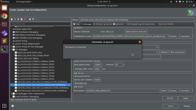

I reviewed the log file you shared. I have a few questions:
1) Could you try to use the 'Test Connection' button in the Debug Configurations menu and share the result?

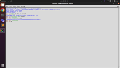

2) Could you open CCS and try the following commands:
delete all
config cc s32dbg:10.42.0.143
show cc
ccs::config_chain testcore
jtag::lock
jtag::reset_tap 1
jtag::scan_in dr 256
(response after this line should be something like:
0x000000000000000000000000000000000000000000000000000000000830101D)
jtag::unlock
(you can locate CCS executable in installation directory, for windows it is C:\NXP\S32DS.3.4_2\S32DS\tools\S32Debugger\Debugger\Server\CCS\bin)
Launch this executable, then double click on it's icon from the system tray to open the console window. Then enter the above commands.

ahmedgheith
Hi Mike,
You can find attached to this reply a couple of screenshots answering questions 1 & 2.
