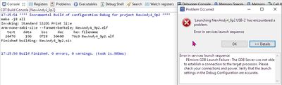

However, if I then update code in the USB2 instance, click the "bug" debug icon to recompile and try to reconnect to USB2 I get the error message
Problem Occurred
'Launching <my_project>' has encountered a problem.
Error in services launch sequence
Clicking Details I then get
PEmicro GDB Launch Failure : The GDB Server was not able to establish a connection to the target processor. Please check your connections and power. Verify that the launch settings in the Debug Configuration are accurate.

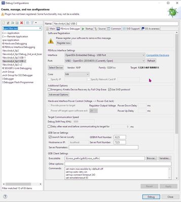

I had both USB connections made with code on both at breakpoints after I had set the LED to red on USB1 and blue on USB2. I then click the "Debug Configurations..." on USB2 connection. On the "PEmicro Debugger" tab I can confirm that both USB ports are showing and both have "[Currently Open]" and the drop-down on "PEMicro Interface Settings 'Port:'" is correctly showing my USB2. When I click "Debug" I get the error message, the blue LED is still lit. Clicking the "Debug Configurations..." on USB2 connection again the "[Currently Open]" has disappeared from USB2 and USB2 is still selected on the drop-down arrow.
I then terminated the USB1, reconnected USB2 and ran to its breakpoint to get the blue LED, reconnected UB1 and ran to its breakpoint to get the red LED (basically back to my starting point above again). I then click the "Debug Configurations..." on USB2 connection. On the "PEmicro Debugger" tab I can confirm that both USB ports are showing and both have "[Currently Open]" and the drop-down on "PEMicro Interface Settings 'Port:'" is correctly showing my USB2. This time, however, I change the port to show USB1 and then clicked "Debug". The connection was successful. However, it was not the board connected via USB1 but the USB2 one that got reset. The USB1 connection was unaffected and I could step though the USB1 connection code.
This is weird (well bugs usually are). To reconnect USB2 change the drop-down to USB1 and then the connection to USB2 works. As a bonus, the real USB1 connection is not affected. This is definitely counter-intuitive but does seem to work.

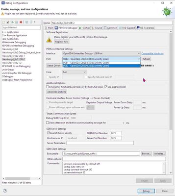

I successfully connected to USB2 instance, then successfully connected to USB1 instance (in 2nd S32DS instance). I then clicked "Debug Configuration" on USB2 instance and this is what I get (I clicked the port drop-down to show you all available ports)
2023-04-20 17_24_22-Debug Configurations USB-2 (showing both USB ports).jpg2023-04-20 17_24_22-Debug Configurations USB-2 (showing both USB ports).jpg
I then selected my USB2 port
2023-04-20 17_24_22-Debug Configurations USB-2.jpg2023-04-20 17_24_22-Debug Configurations USB-2.jpg
Then I click the "Debug" button at the bottom and, after recompiling, eventually get this
2023-04-20 17_31_14-Problem Occurred.jpg2023-04-20 17_31_14-Problem Occurred.jpg

In the port selection, whenever you see a "[Currently Open]" next to the selection, that means that the OpenSDA is still active.
Can you please make sure you terminate your debug session before clicking the "bug" debug icon?

After you have updated the code in the USB2 instance and before you click the "bug" debug icon, can you please open the debug configuration dialog and make sure the correct port (USBn - OpenSDA (zzzzzzzz)) is selected? If you click on the drop down arrow, it should show both OpenSDA connections.
4,027件の閲覧回数
DarrenD
You may have found the perfect workaround - I think it's still a bug but it is a less intrusive workaround!
[edit] My only conclusion is that the drop-down USB2 is being treated as "the 2nd available USB connection and since my USB1 is [Currently Open], i.e. not available, my USB2 is now the 1st available USB and since there are no other USB connections there is no 2nd available USB, hence the error message". This is a completely wrong implementation (if that is how it is being handled) since the USB connection actually says "USB2 - OpenSDA (xxxxxxxx)". The "xxxxxxxx" is some sort of serial number for the board since if I unplug one USB cable I now have USB1 only and plugging into board 1 I get "xxxxxxxx" and plugging into board 2 I get "yyyyyyyy". Therefore, the USB connection knows which board it is talking to (xxxxxxxx or yyyyyyyy) so the IDE should be able to correctly identify the USB cable and/or board, hence why I call this a bug.
