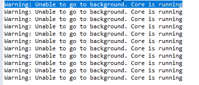

Console:Warning: Unable to go to background. Core is running.
2,098 Views
liuruowen
Hardware: S32K144EVB
IDE: S32DS ARM 2.2

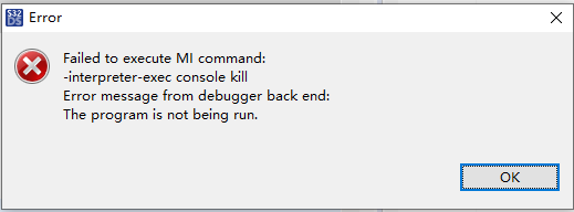

When I debug using the ELF file,the program runs until it enters VLPS mode,and click 'Suspend' and 'Terminate',the problem as shown in the following picture appeared.
What's the problem?
1,793 Views
juan_see
Hi liuruowen,
Unfortunately, Low power mode is not supported by PEmicro.
