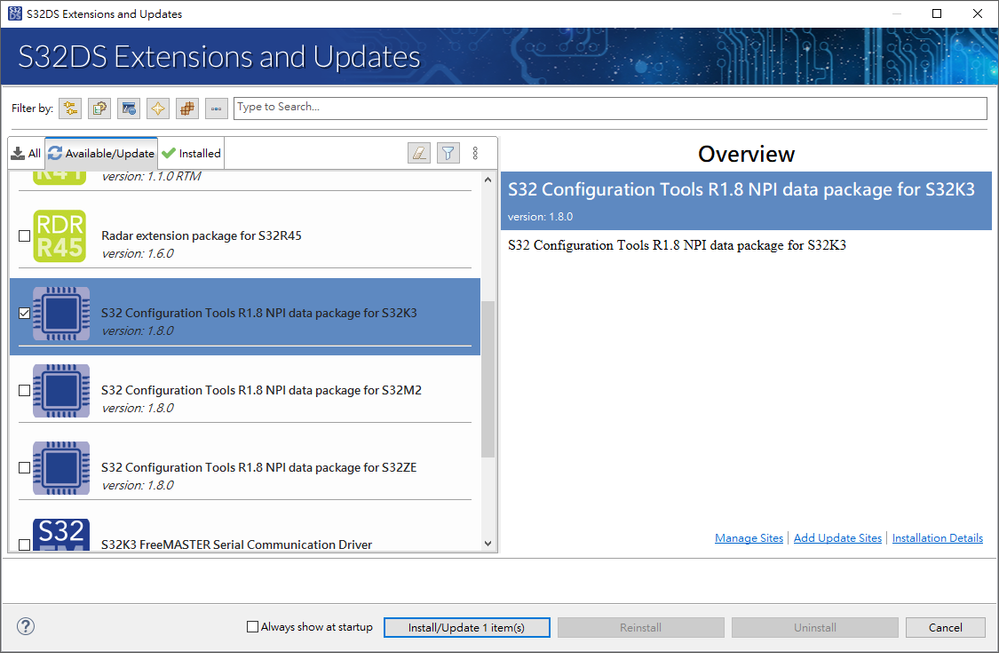

An error occurred while installing the configuration tool. What might be missing?

Hi @AdamsCheng
Before installing the SS32 Configuration Tools R1.8 NPI data package for S32K3, please ensure that the S32K3_S32M27X Real-Time Drivers AUTOSAR R21-11 Version 5.0.0 are installed. The update can be found at:
S32K3 Standard Software > Automotive SW - S32K3/S32M27x - Real-Time Drivers for Cortex-M > S32K3_S32M27x Real-Time Drivers AUTOSAR R21-11 Version 5.0.0.
