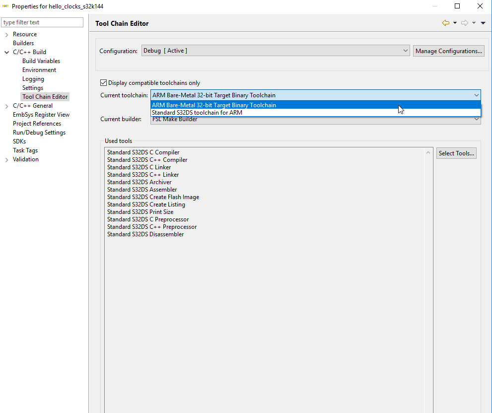

jiri_kral
Hi Lutz,
just change the toolchain to ARM Bare-Metal 32-bit in project properties:
Now you should be able attach SDK RTM 2.0 version:
Jiri

when I change the Toolchange, I have the next problem. I cannot attach that S32K14x_AMMCLIB_gcc.
and I cannot build
It’s not nice to one problem after another by change the SDK.
Have you a solution for my “startup.c” problem -> see last email?
I think, I need a new linker file for the SDK RTM 2.0.0.
But where find it or how can I create a new one?
Lutz

jiri_kral
Um - I see. Unfortunately - ammclib is not supported by new toolchain yet. Well - it is catch-22 case.
What is your issue with startup.c file ( I can't find details in previous email).
Jiri
