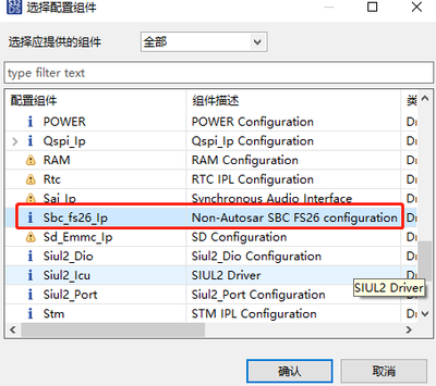

Have you found any compatibility problems between FS23 and FS26 in S32DS3.5?
When I install FS23 and FS26 at the same time, they overwrite each other, just like S32K3's RTD3.0.0 and RTD4.0.0.
We can solve the problem of RTD incompatibility by installing two S32DS3.5. But how to solve the incompatibility between FS23 and FS26 in the same RTD version?

这个应该是IDE 本身的bug,一般情况下客户的一个project不会同时出现FS23 FS26因为他两个都是SBC。

Will you report such problems to the corresponding team? Because the SBC used in the S32K3 series is different, for example, S32K312 will use FS23,S32K344 and may want FS26.
By the way, is there a better solution to the problem of RTD3.0.0 and RTD4.0.0 compatibility?

我不support IDE的,但是你可以提交ticket可以上报到IDE software team,会有人帮解决。
