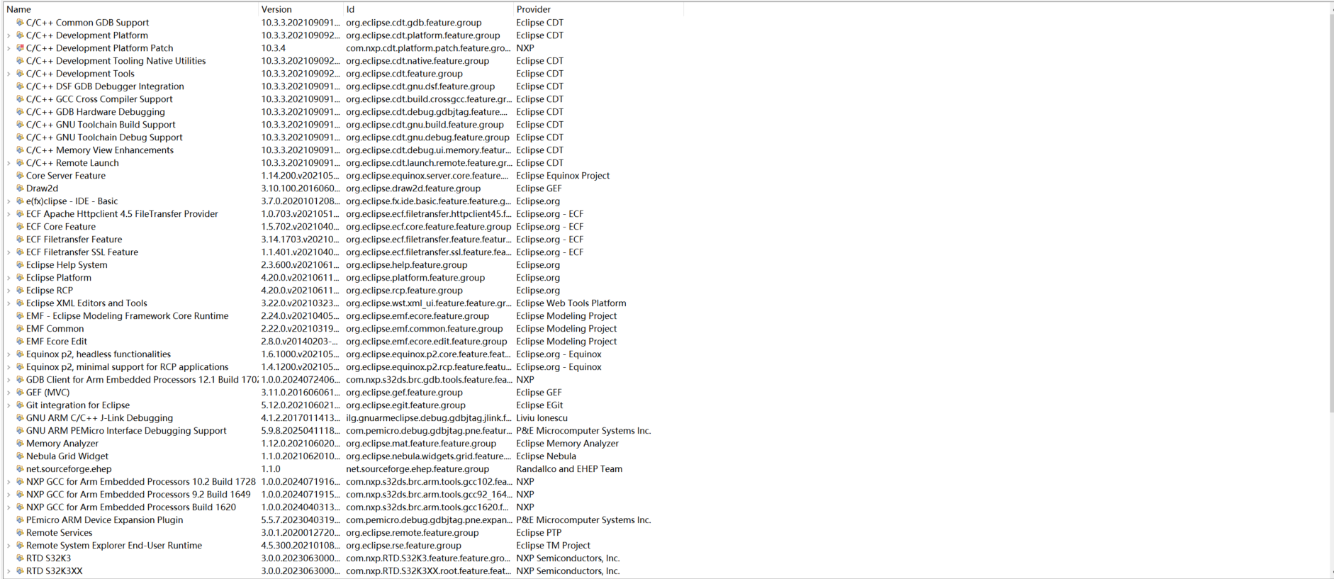

When I create an S32K312 project using S32 3.5, I cannot generate code in the Peripherals Configuration Tool. My installation details are shown in the image.

if you hold mouse pointer above the error message, isn't there some detailed description of the error?

I tested your demo project and when I try to open config tool, it says that .mex file is corrupted. If I deleted the .mex file and let Config Tool create new one, I can normally generate code and use Config Tool without any issue.
If the corrupted .mex file was unmodified - I suggest to re-install S32DS.
