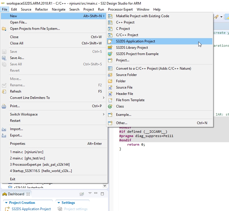

My S32 version is as below:
S32 Design Studio for ARM
Version: 2018.R1
Build id: 180326
I do not know what is happening for the below information in the console?
14:18:15 **** Build of configuration Debug for project S32K_Ranger4 ****
 -j4 all
Cannot run program "": Launching failed
Error: Program "" not found in PATH
PATH=[C:/NXP/S32DS_ARM_v2018.R1/eclipse/jre/bin/client;C:/NXP/S32DS_ARM_v2018.R1/eclipse/jre/bin;C:/NXP/S32DS_ARM_v2018.R1/eclipse/jre/lib/i386;C:\ProgramData\Oracle\Java\javapath;C:\windows\system32;C:\windows;C:\windows\System32\Wbem;C:\windows\System32\WindowsPowerShell\v1.0\;C:\windows\System32\OpenSSH\;C:\Program Files\TortoiseSVN\bin;C:\Program Files (x86)\Intel\Intel(R) Management Engine Components\DAL;C:\Program Files\Intel\Intel(R) Management Engine Components\DAL;C:\Program Files\Intel\WiFi\bin\;C:\Program Files\Common Files\Intel\WirelessCommon\;C:\Program Files (x86)\Box\Box Edit\;C:\Program Files (x86)\Symantec\VIP Access Client\;C:\Program Files (x86)\Sennheiser\SoftphoneSDK\;C:\Users\shdqinli\AppData\Local\Microsoft\WindowsApps;;C:\NXP\S32DS_ARM_v2018.R1\eclipse;]
14:18:17 Build Finished (took 2s.78ms)

how you import/create your project? If it is an existing project - you need to import it into workspace:
If you created new one - be sure that you choose S32 Application Project:
Jiri

Hi Jiri,
It is a existing project from NXP and I have resolved the problem by updating the SDK with S32DS_ARM_v2018.R1_UP10 and S32DS_ARM_v2018.R1_UP11 and S32DS_ARM_v2018.R1_UP9.
Thank you all the same!
