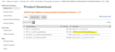

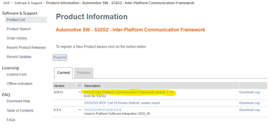

mikedoidge
Hello @Somasundaram_Vadivelu ,
It seems that there is already a newer version of this IPCF package:
Take the file IPCF_1.1.0_D2012_updatesite.zip:
It has more complete S32 Design Studio integration and uses the latest version of S32DS 3.3
From S32_IPCF_1_1_0_D2012_ReleaseNotes.txt:
Hope it helps,
Mike

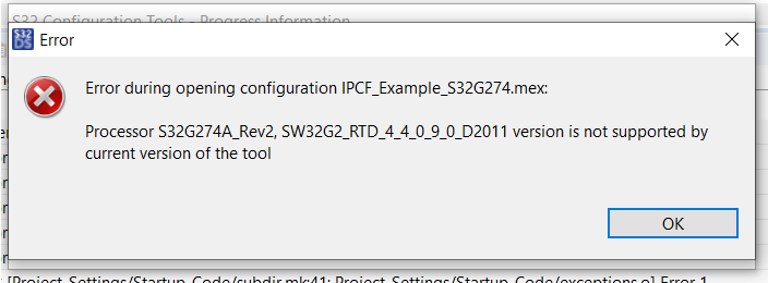

Thanks and I really appreciate the fast response.
I tried to select any one of the tools from S32 Configuration Tool option but I get this error pop up.
I use S32DS 3.4 version.
8,208 Views
mikedoidge
I used S32DS 3.3, as this is the version of S32 Design Studio which is listed as supported in the release notes for the IPCF example. I suggest you stay with 3.3 ,for now. The IPCF example was not updated to use the SW32 RTD 4.4 v1.0.0 (this is the only version of the RTD that is supported by S32DS 3.4). Again from the release notes for the IPCF example, it specifically states the SW32 RTD 4.4 v0.9.0 is what is supported.
Mike
