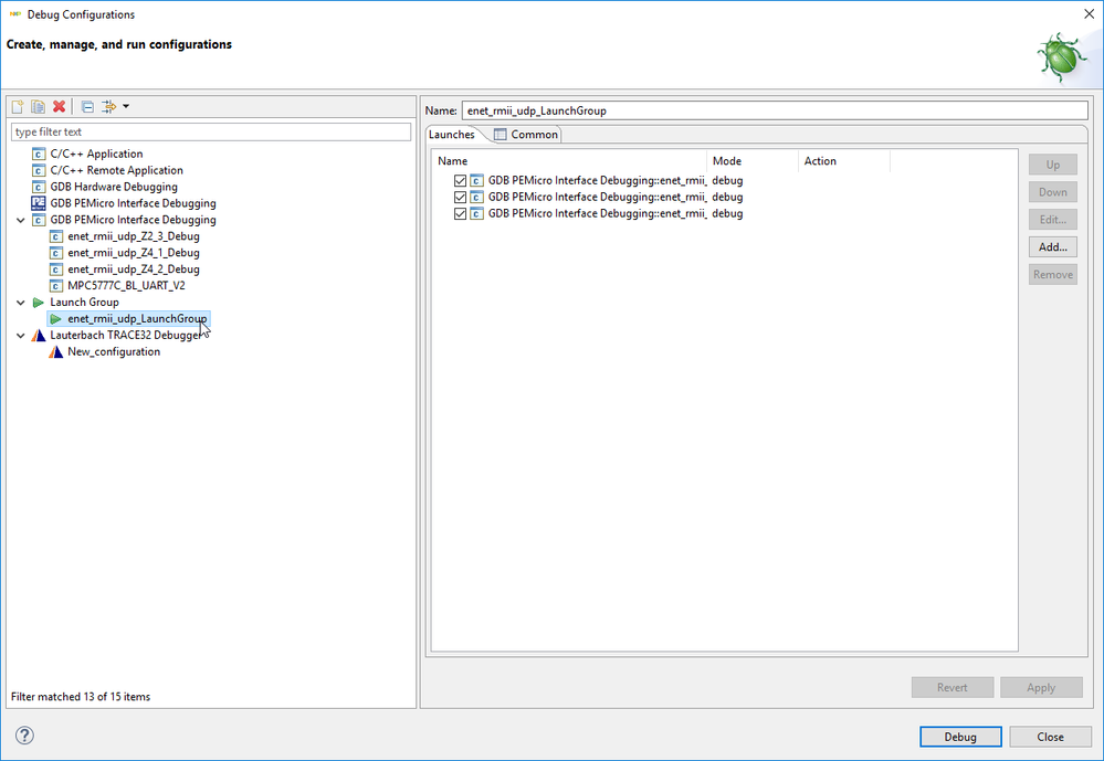

I trying to run the ENET_RMII_UDP code in the S32DS. While running in the terminal I saw a note "Note: automatically using hardware breakpoints for read-only addresses". I run another program in the same environment and that work well without any problem.
I want to know the reason why the program does not reach the break point in the main function? The IDE shows that the program is running, but I didn't saw any packets sending from the board. It also take lot of time to stop the execution after I click the stop button.

Hi Rahul,
I tested the example with DEVKIT-MPC5748G - and I can reach breakpoint on main() without any issue. Make sure that you are using debug launch-group or boot core for multi core MCU:
Here is output from my debug console for reference:

monitor selectcore 0
Warning: the current language does not match this frame.
continue
Continuing.
Note: automatically using hardware breakpoints for read-only addresses.
Temporary breakpoint 1, main () at ../src/enet_rmii_udp_Z4_1.c:47
47 {
set architecture powerpc:vle
The target architecture is assumed to be powerpc:vle
No breakpoint number 2.
Hope it helps.
