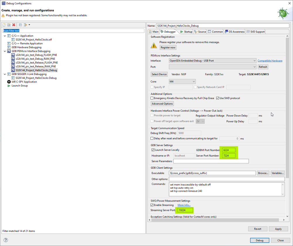

'Launching  lpuart_echo_s32k146_debug_flash_pemicro'has encountered a problem.
Could not determine GDB version after sending:D:\software\NXP\S32DS_ARM_v2.2\eclipse\../S32DS/build_tools/gcc_v6.3/gcc-6.3-arm32-eabi/bin/arm-none-eabi-gdb --version,response:
 Can't Debug S32k Board  while I connecting Network
How can I deal with this problem?
when I disconnect the internet,I can debug my s32k board.~
but sometimes I need to connect my PC from  remote PC to Debug my remote board.
So I need to deal with this problem......

it must be some netwrork/firewall/port settings (port used for debug may be taken by other application)  issue on your PC. If it is your private PC - try to figure out, if the machine is from your company - ask your IT department for fix. You can also try to change port settings in debug configurations:
To be honest - as far I remember - it is very first time when such issue is reported.

Hi jiri,
    Ths for your reply.
I have two company PC also have this issue,and my colleague also have this problem..it may be company IT department do something wrong..but  my company IT department they  dont't   know how to fix it........
I try to change port settings in debug configuration ,but it not work,Can you share what the value should be set in bebug configurations or remote to control my PC to check this issue?
Best Regards  , Ths.
2,585 Views
WEIZIQI
I fix this issue , Ths! I delete my debug file and new one, set as your picture's parameters , Ths for your attention
