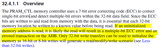

In the startup_s32k148.S file, the following codes  do RAM ECC function. Can't understand it! Need help or guide! Thanks!
#ifdef START_FROM_FLASH
/* Init ECC RAM */
ldr r1, =__RAM_START
ldr r2, =__RAM_END
subs r2, r1
subs r2, #1
ble .LC5
movs r0, 0
movs r3, #4
.LC4:
str r0, [r1]
add r1, r1, r3
subs r2, 4
bge .LC4
.LC5:
#endif

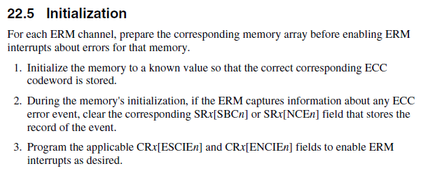

Hi Kongdetao,
this routine is initializing the RAM to a known value (0).
This because according to ref manual, point 1:
Furthermore, if you are using a device with PRAMC:
Then, last but not least, :
