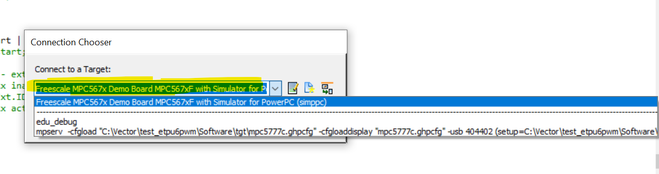

We use MPC5775E as a microprocessor. We want to implement CAN communication, but I couldn't find any working examples. Could you share an example where I can learn how to integrate can communication on MPC5775E?

Thank you very much for your help and interest. When I reviewed the family comparison section in the MPC5775E's reference manual, I saw that I could use these examples. Actually I want to integrate CAN communication without using SDKs.
I tried both links you shared.
My comments for the https://community.nxp.com/docs/DOC-332326 example:
- It can be built.
- Receive and transmit messages do not appear when connected with PCan View. So CAN messages have no output.
My comments for the https://community.nxp.com/docs/DOC-334350 example are:
- It can be built.
- But the evaluation board is not flashed.
- Cannot select the correct target.
So, as a result, either I could not run the examples or there are missing examples. How can we solve this situation?
