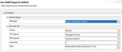

I`m creating a C/C++ application on S32DS specific for the S32K344.
Since on C++ there is no RTD, I saw a few solutions on the forum that "migrate" the C project to C++, however when I do the following process, some errors occur:

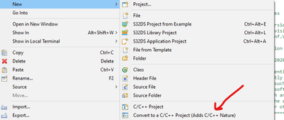

I create a C project and add the SDK:
Then I add the nature of C++ to the project

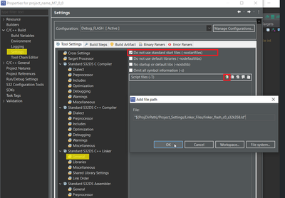

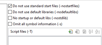

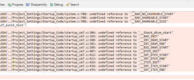

I tried also to do not use standard start files, but some other errors show up then:
Tried also copying the linker files, but no solution.

Hi @RBSamuel ,
I guess my manual was not complete. Based on your error messages I think you need to add your linker file:
Andreas
