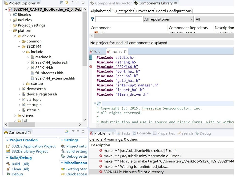

  I open the demo project  S32K144_Bootloader_v2_0, then bulid it, but get some errors.
It's strange that this project have "S32K144.h" file but get one error "S32K144.h:No such file or directory".
Wish supports!
Thanks!

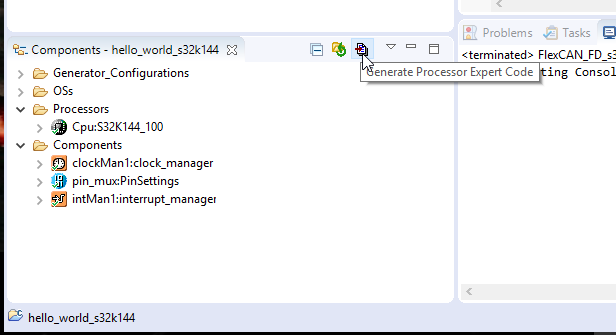

you probably forgot generate processor expert code:
Jiri
