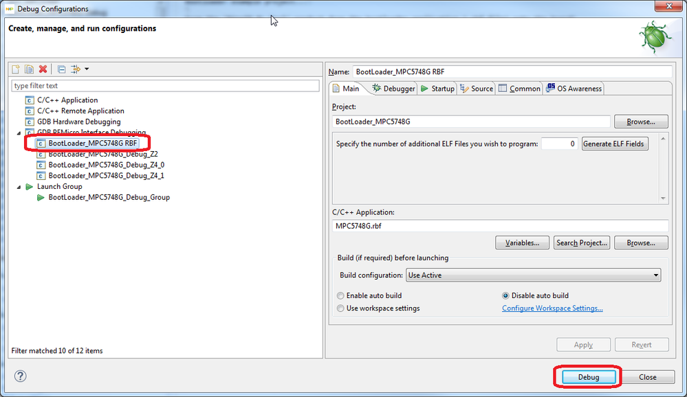

First you need to program /rbf file which is actually the bootloader binary. This could be done by OpenSDA (see the screenshot below) or any other Debug cable you have (PEmicro Multilink, Universal, FX..)
There is pre-configured debug configuration that loads the bootloader binary:

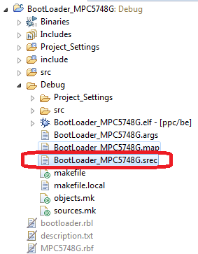

Then you can build the Application which basically blinks LEDs on the board. The generated project + its SREC is located here:

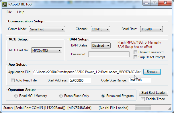

Now download install and run RAppID Bootlader utility:
(https://www.nxp.com/webapp/Download?colCode=RAPPID_BOOTLOADER_UTILITY&appType=license&Parent_nodeId=... )
you should be now able download the generated application project (s-record) via Virtual COM over USB cable (COM15 on my machine) into the board.
