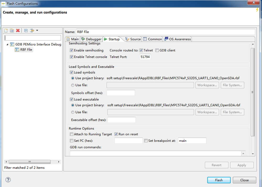

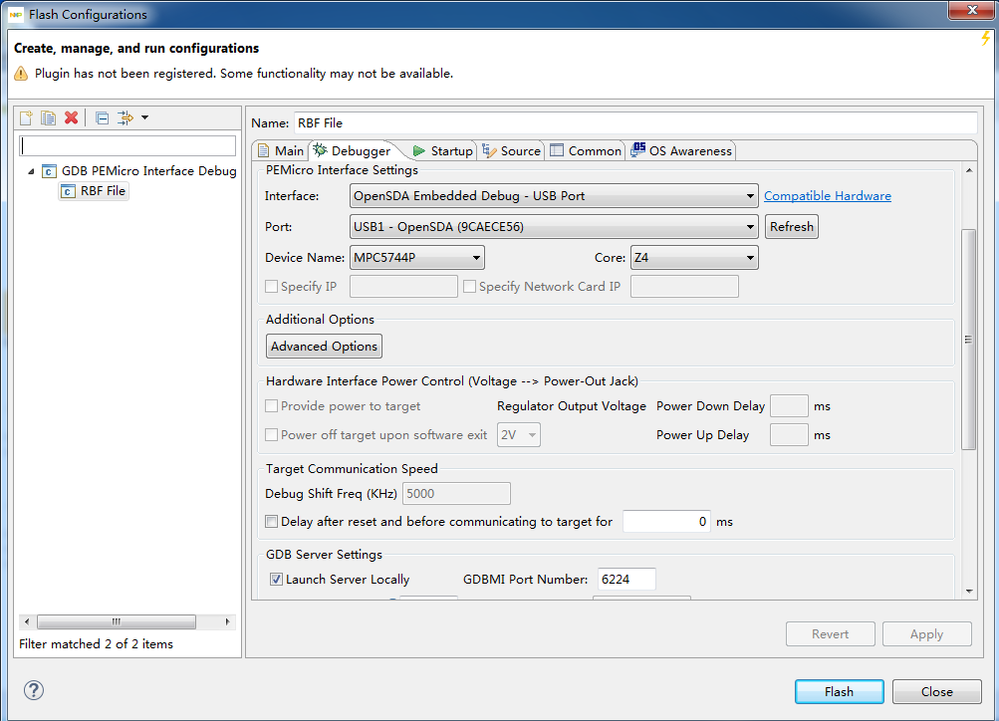

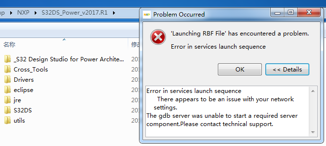

An error occurred while using devkit-mpc5744p (opensda) to flash the RBF file。
What can I do to solve the problem?
Software:S32 Design Studio for Power Architecture Version 2017.R1
                win7 32bit
【Error in services launch sequence。There appears to be an issue with your network settings.
The gdb server was unable to start a required server component.Please contact technical support.】

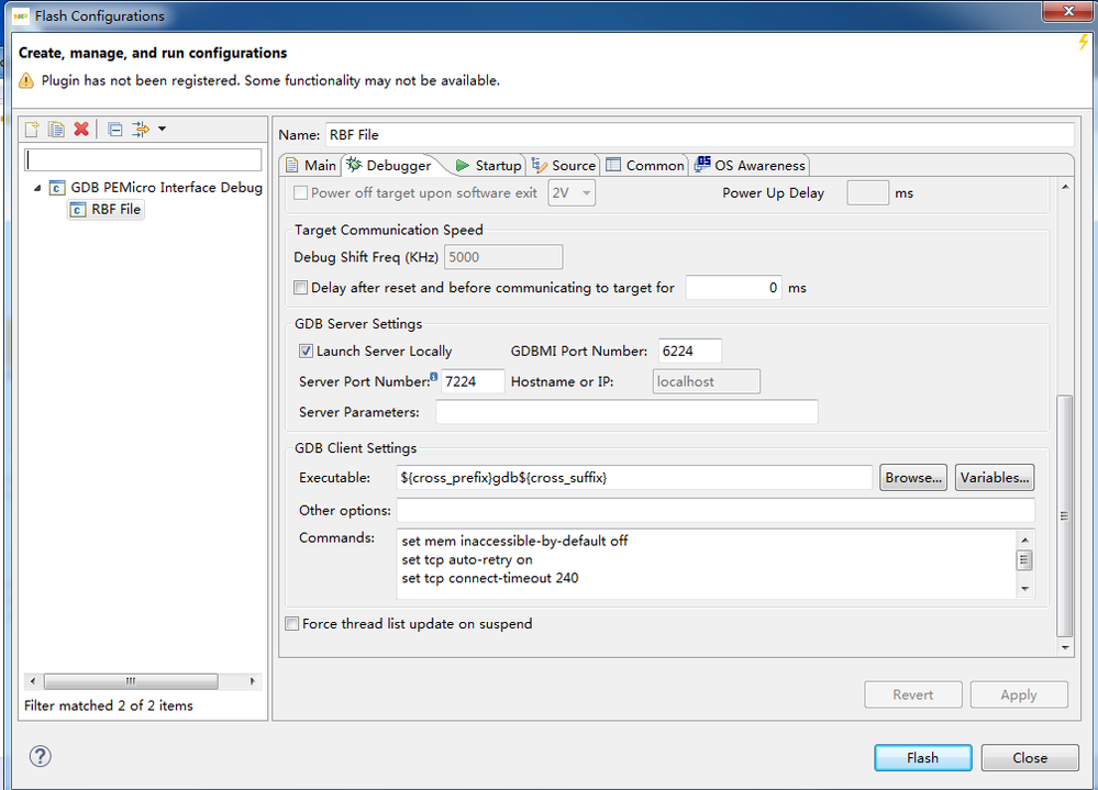

Please check if the TCP port dedicated to GDB  (7224, 6224) is not used by any other process in your system.
Under Windows OS go to command line  (as Administrator) and type:
netstat -ab‍‍
Another issu that might occur is file protection. Please make sure all the files are accessible so that GDB can run without problems.
