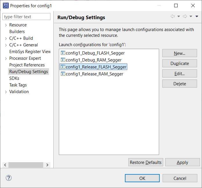

Standard example hello world I get four configurations, combinations of debug, release, flash, and ram:

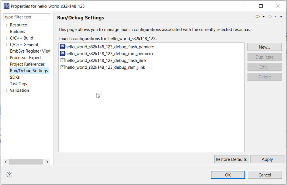

If I do the same from the SDK RTM hello world example, I get four configurations, two debug for PEmicro, and two debug for Segger jlink:
I'm using the jlink, so I would delete the PEmicro configurations.  But I do need to add in Release_FLASH and Release_RAM configurations that are missing.

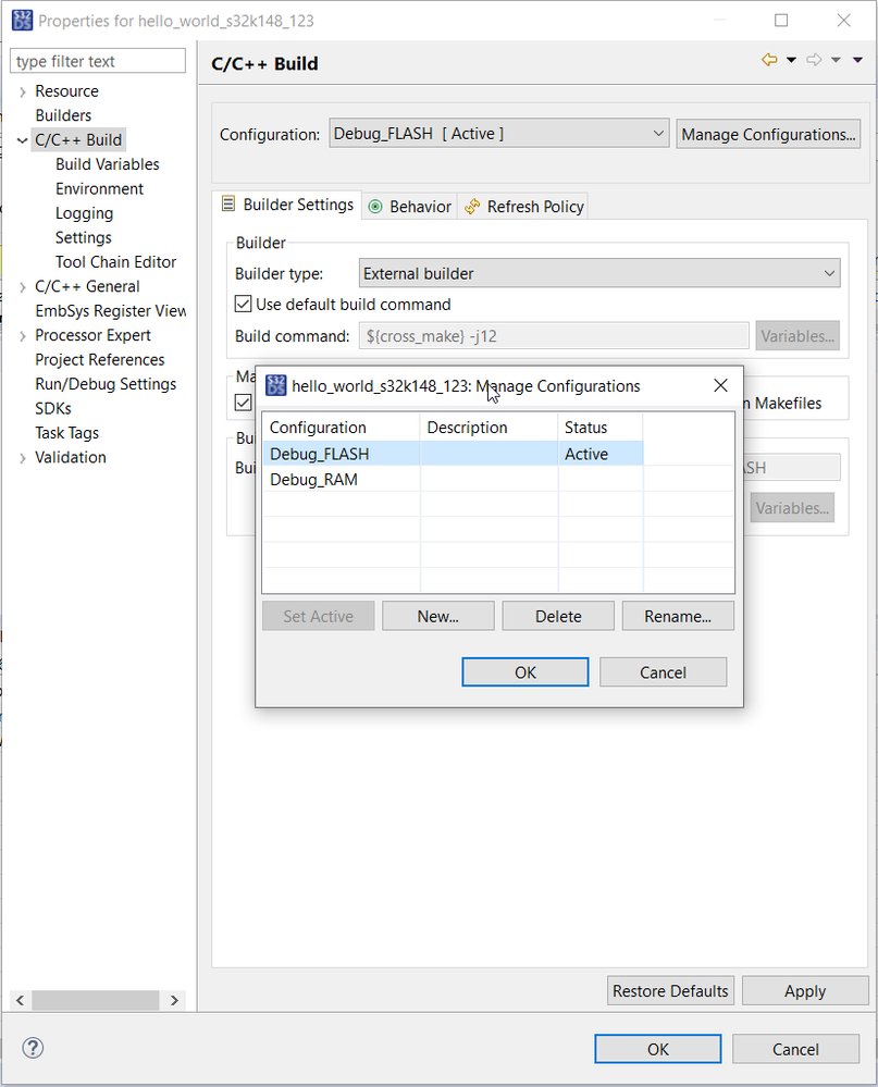

What are the exact steps needed to accomplish this? If I click New, it seems that there are some other actions that need to be taken first?  I think I need to add a build configuration in the project C/C++ build properties first:
If I use the default configurations, the build settings and paths are not right and the project doesn't build.
If I copy the configurations from the existing debug configurations, the settings are not right for Release.
I wonder if there is a guide somewhere about the right steps to take, or some advice about an easier way forward.

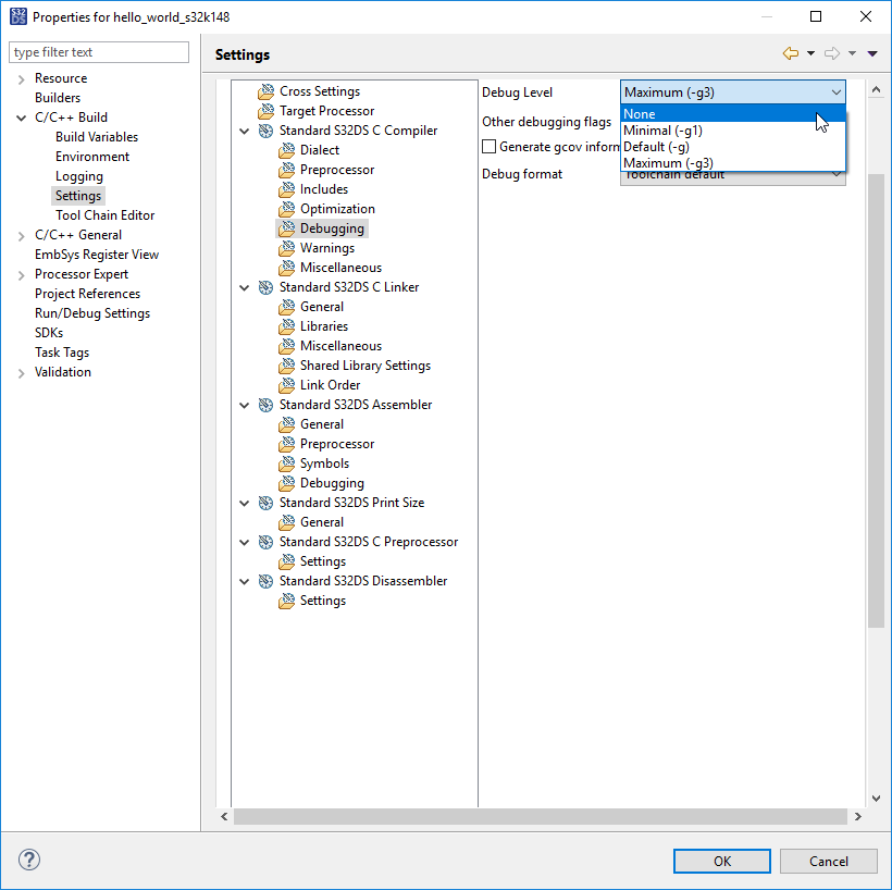

Best way is copy existing configuration - Debug_FLASH (or Debug_RAM).
The only difference between Release and Flash is, that .elf file for Debug contains symbols a other debug info. If you like to build release .elf - set debug level to None for Release_FLASH configuration:
Hope it helps.
